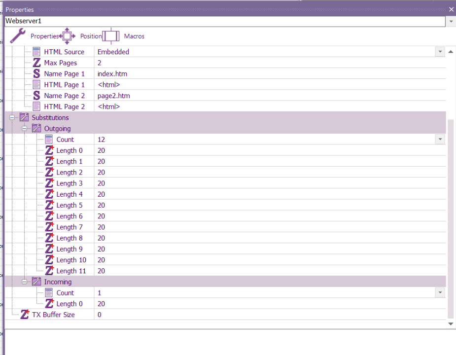

I belive the Webserver component and the number of outgoing substitution create the problem.
It looks to me that no more then 5 substitutions are possible. The componet allows up to 12.!!!??? :o

....add on and observation number 2 regarding the Webserver Component.
I tried to use only one or two outgoing substitution strings. Just to make the string itself longer and fill it with more static and dynamic data.
Unfortunately you can not go longer then the default value of 20. Even if you define a string variable "test[50]" and [50] definition for
the outgoing substitution string inside Webserver prefernces.
So from my point as a first conclusion.
1. More working outgoing substitution strings, for example 20 would be great and perfect
or
2. Longer outgoing substitution strings should be possible
Matrix team could you please be so kind an advice.

Thanks again for letting us know, should be all fixed for you now.
Let me know how many you would need and I'll try and get them added for you.
Edit. I've now increased the outgoing count to 30 and the incoming count to 10, hopefully that should help.

30 out and 10 in seems to be fine. At least for me.
