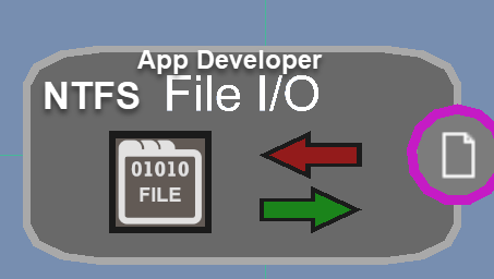

A additional component just working in the App Developer called NTFS File I/O.
should be extremely fast and very simple to use.
Just a buffer or a DSP component to define and some information for the header.

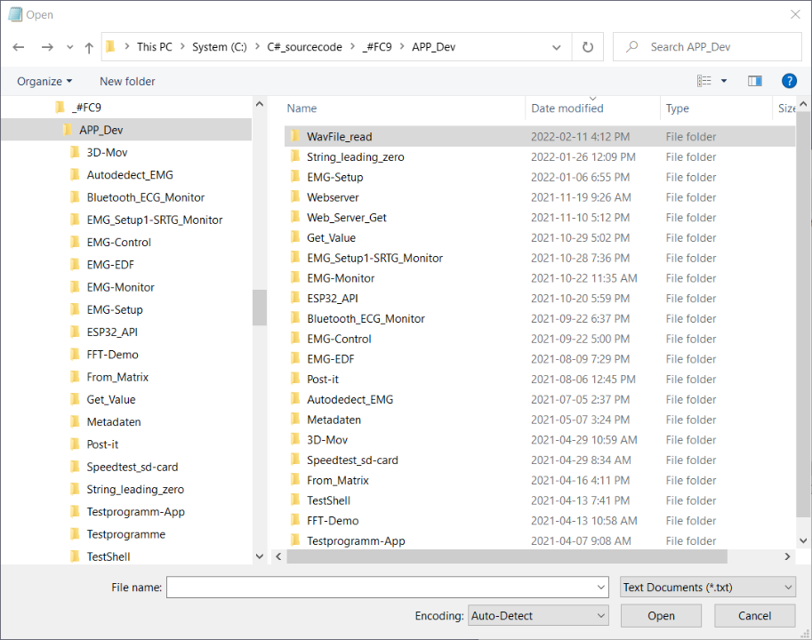

Would it be possible to have a simple file open menu in the future?
To make it easier to browse and select a file.
Like this example:
I would like to open with the App Developer, some data file, that was created with FC9 and a PIC, so that I can analyze it.Is there a way to have a File open / File save menu in the App developer?
Like this example:
- menue_2022-02-11_16-41-24.png (221.06 KiB) Viewed 5361 times

Using the built-in fuction in Flowcode APP Developper is working nice.
Only a File-open menu is missing. Is there a possibility to create something?
I created a short info how easy file read/write with the app is but somehow a selection when opening a file would be a good addition
