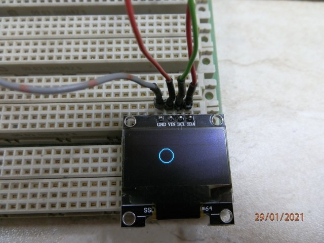

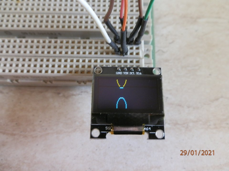

I experiment with OLED Display 128x64 I2C. I found that he not display correct circle.
Rectangles are Ok. I use PIC18F2525.

Re: gLCD_SSD1306_i2c not correct display circle
Maybe try setting the interlaced component property to Yes. Hopefully this should solve the problem for you.
Post by maharadga »
Thank You, BenR, this solve problem with circle.

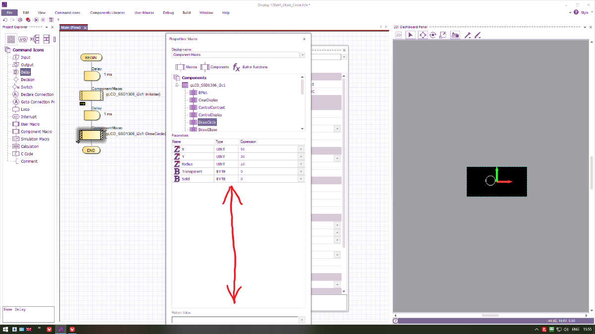

But still exist big empty space in Properties Component Macro.

Re: gLCD_SSD1306_i2c not correct display circle (Solved)
Excellent glad the display is working correctly now.
The icon properties window can be resized and simply remembers the size you set it to previously. The blank space is normal.

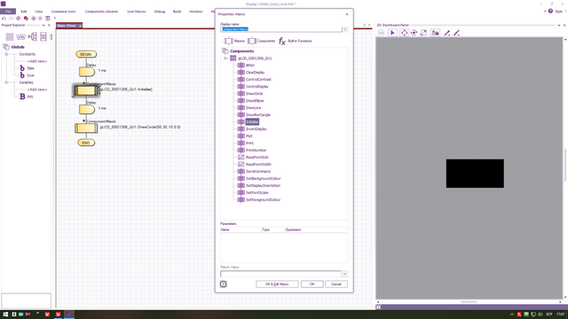

Post by maharadga »
If I try resize icon, increases only blank field. Window with properties stay small.
Have differences in two icons of the same component , like seen on the pictures.
I think must be available option resize the windows individually.
And Fc9 not remember resized Icon, like You say.
