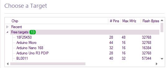

Also I have explored and if I do left-click over the Choose a target selection area, in the pop-up menu that appear, I can hide the unlicensed chips and is more easy to read and choose the licensed or free targest availables.
Choose target.JPG (22.93 KiB) Viewed 3855 times
