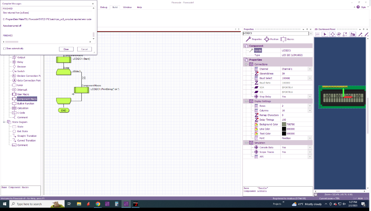

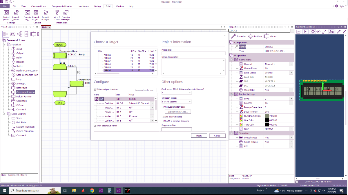

Hello, I have the same problem. I don't know what pins I still need to configure, I'll attach a pictureImage
Posts: 2478
Has thanked: 795 times
Been thanked: 858 times
Re: error when compling
Unfortunately, Images like that don't help.
