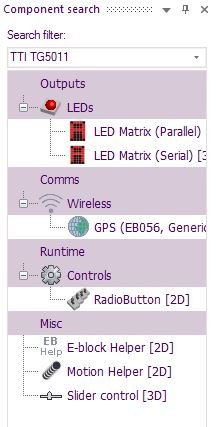

I don't see it at all in v10 Libraries > Api, only Slaves Devices and Injector Boards. A search doesn't show much either

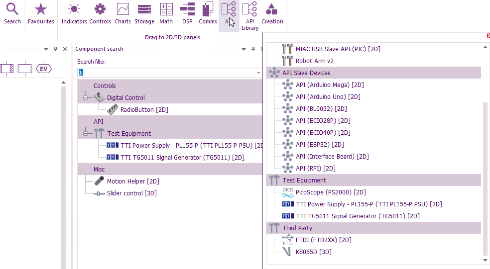

Posts: 2325
Has thanked: 724 times
Been thanked: 783 times
Re: Flowcode 10 Component: TTI TG5011 Signal Generator
Hi Iain
It might be you are not in App Developer mode?
Embedded and App developer modes can show different components that are available.
App Developer mode.png (64.4 KiB) Viewed 3616 times
To go into app developer mode, it's New Project, selct the App Developer tab, New Blank App Developer Project Or Select from the Template list.
