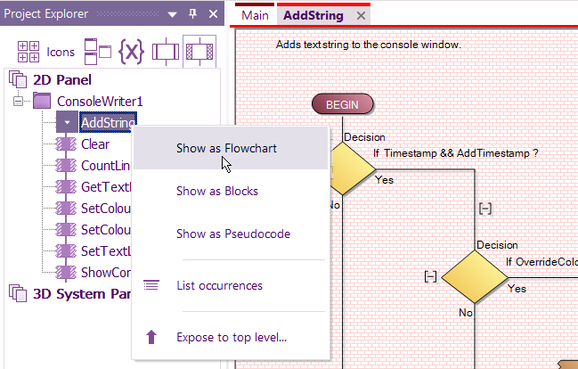

In addition, users with the Professional pack will have access to 2 additional features:
1) View code for components directly in their projects (by right-clicking on macros in the "Components" tab of Project Explorer)
show component code.png (46.98 KiB) Viewed 4070 times

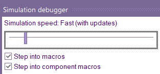

2) Step into component code when simulating
step into component code.png (5.27 KiB) Viewed 4070 times
