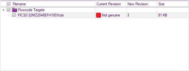

Hello Ben
a small problem has remained.
FC always wants to give me a newer version of the
32MZ2048EFH100.fcdx file.
see picture.
With kind regards
SpeedPic32
Posts: 2478
Has thanked: 795 times
Been thanked: 858 times
Re: small clock error PIC32MZ2048EFH100
Hi SpeedPic32.
If you replace the current file with one from the forums, that file will be marked as not genuine.
The new revision shown will be the revision of the file you replaced if there have been no further updates.
If the revision was 2 when before you replaced the 32MZ2048EFH100.fcdx file then you can update with revision 3.
If the revision was 3 before you replaced the 32MZ2048EFH100.fcdx file then you will need to wait for revision 4.
It looks like the last time PIC32MZ2048EFH100 was replaced was on 10/11/21
Therefore the file can be left showing Not genuine as that is expected.

Hello Medelec35
Thanks I will wait for version 4 :D

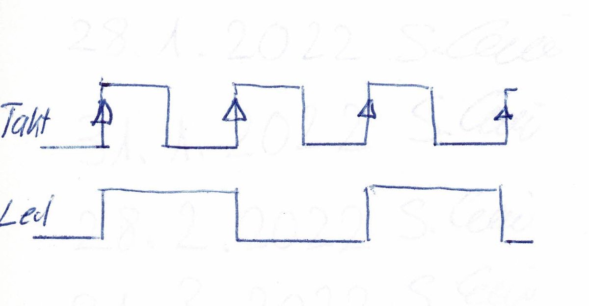

One more question about your program.
I suspect that your problem comes from the "Takt"
If you always trigger an interrupt on the positive edge, your clock will be halved, so half of the speed would be fine.
Can you test if that is the reason?
