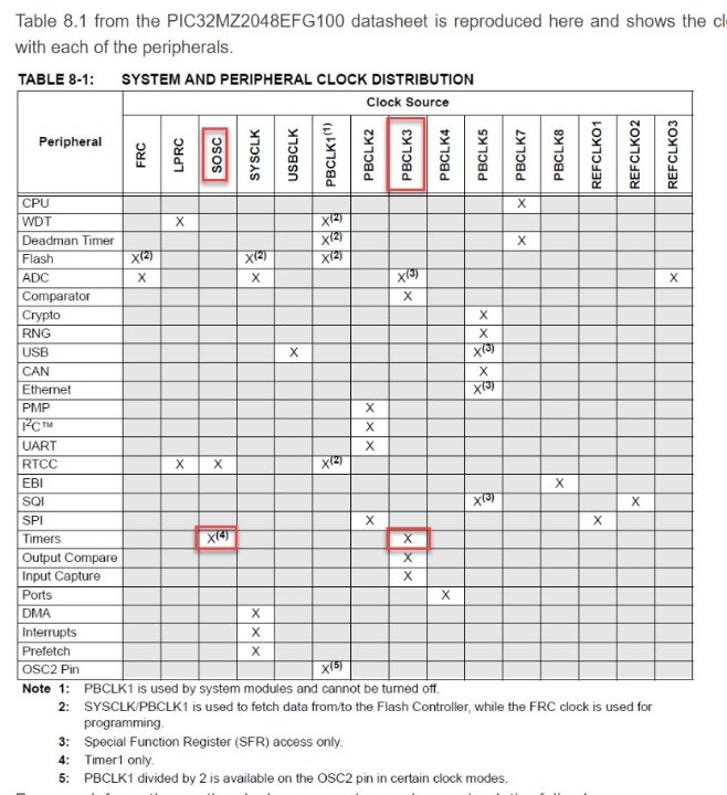

It looks like we are expecting the interrupt clock to be the same as the main core clock and a previous mod I did to change the UART/SPI clocks to be correct has effected the interrupt clock too.
For now please can you set the rate to be 2X what it should be and I'll see if I can narrow down the range of effected devices here to provide a fix that doesn't cause more knock on problems with other devices.
