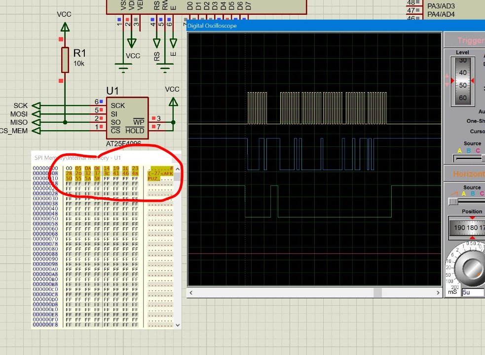

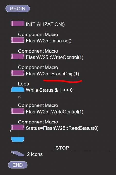

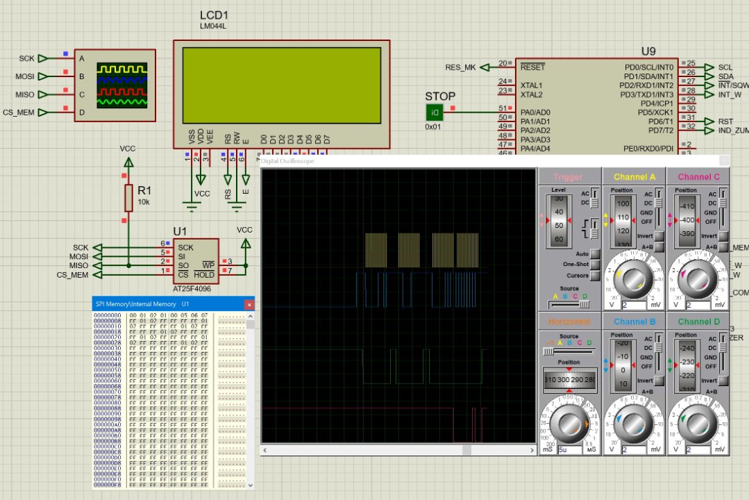

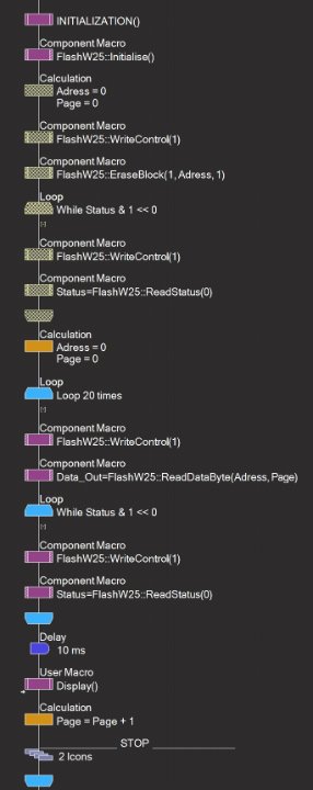

Erasing doesn't work
Proteus
Proteus
EraseChip Prot.jpg (156.05 KiB) Viewed 9713 times
Program
Program
EraseChip.fcfx
Prog
(22.99 KiB) Downloaded 584 times

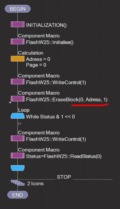

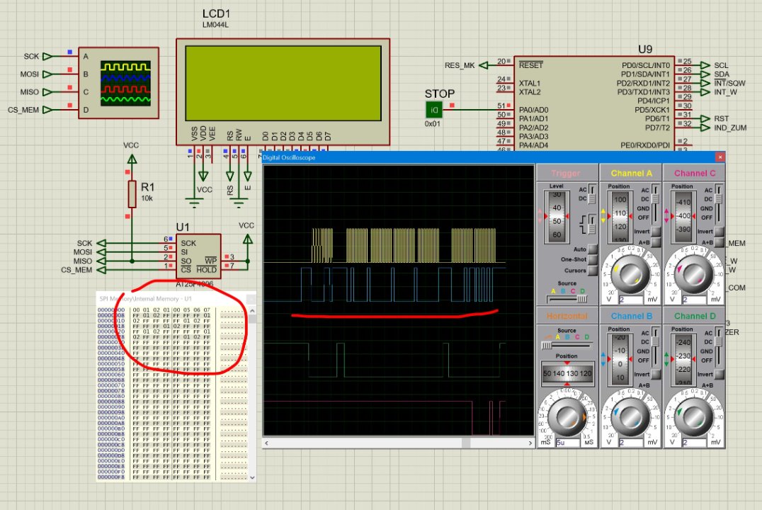

Erasing 4k does not work
Proteus
Proteus
Flow
Flow
EraseBlok 0.jpg (38.96 KiB) Viewed 9713 times
EraseBlok 0.fcfx
Program
(23.29 KiB) Downloaded 613 times

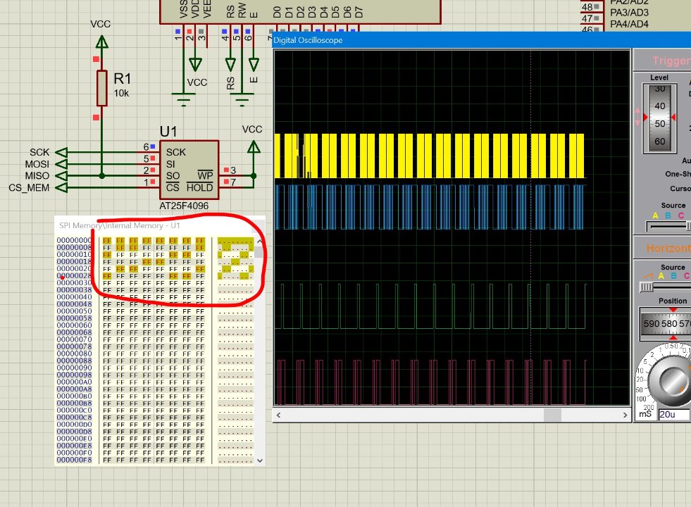

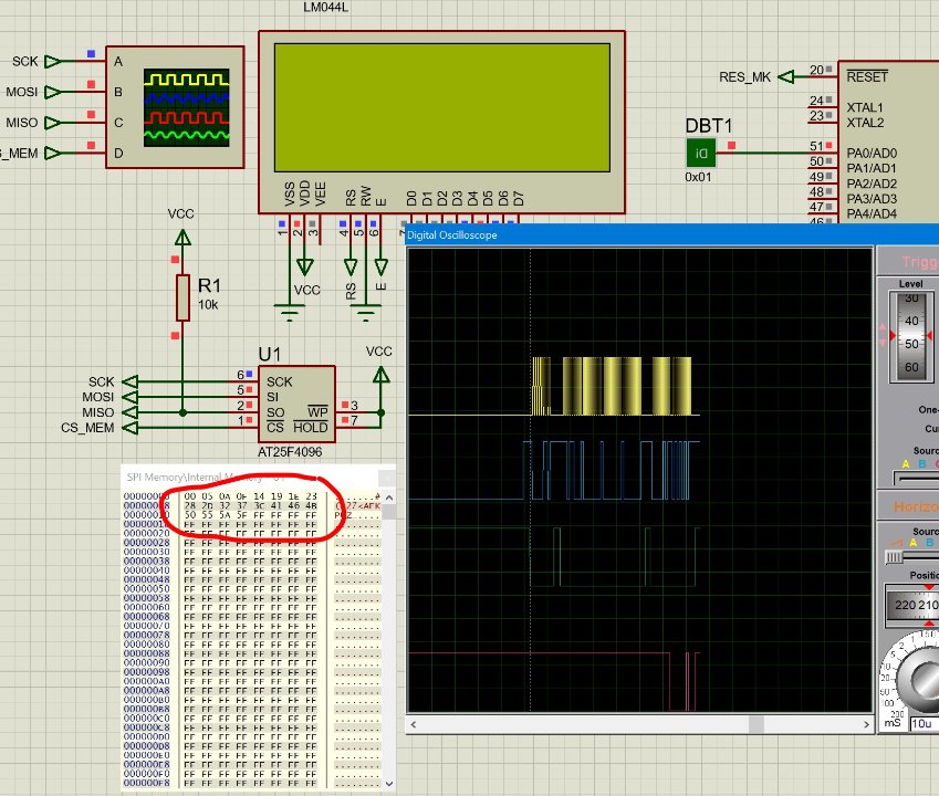

Erasing 32k works
Proteus
Proteus
Flow
Flow
EraseBlock 1.jpg (40.08 KiB) Viewed 9713 times
EraseBlock 1.fcfx
1Prog
(23.29 KiB) Downloaded 631 times

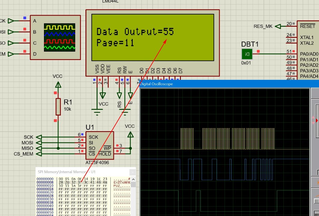

Recording probably works.
Prot
Prot
WriteDataByte.fcfx
Prog
(25.48 KiB) Downloaded 687 times
Flow
Flow
Osta
Posts: 60
Joined: Thu Dec 10, 2020 1:12 pm
Has thanked: 1 time
Been thanked: 5 times
Re: Flash W25 reading doesn't work
Post by Osta »

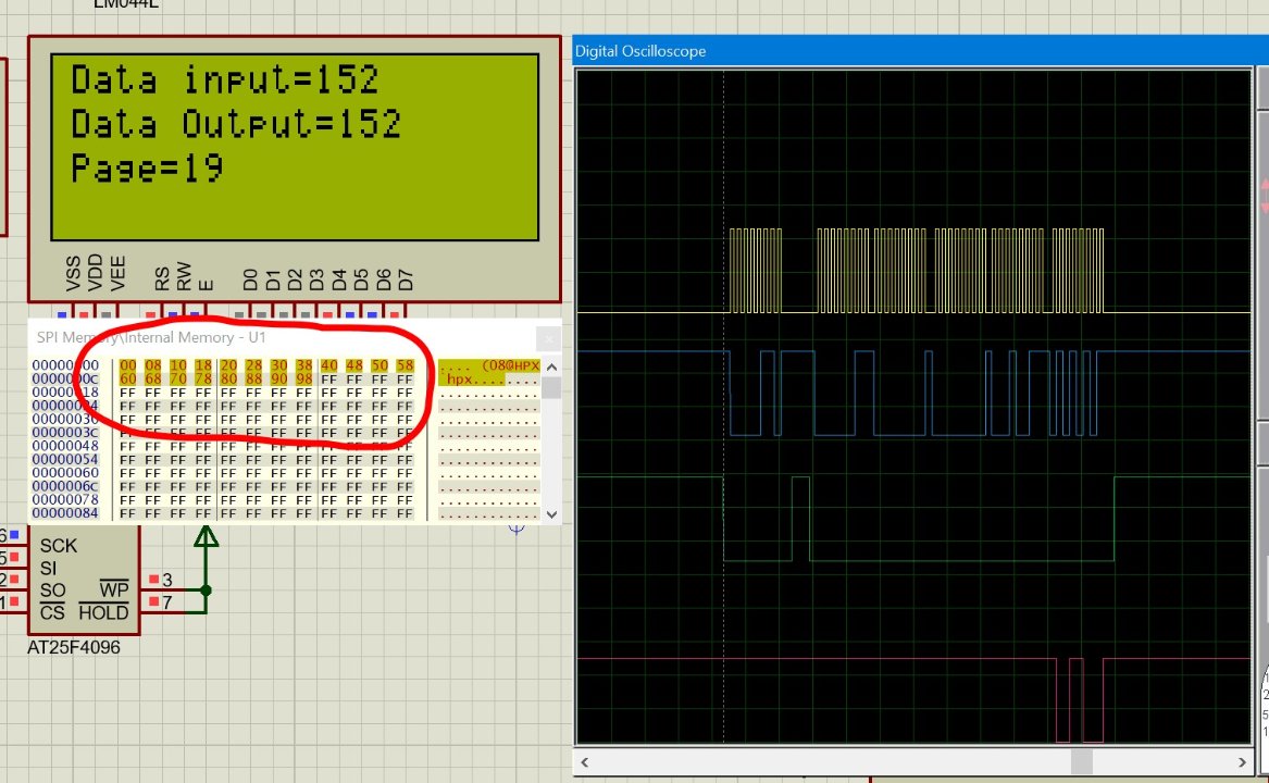

Reading works, too.
Prog.fcfx
Prog
(25.89 KiB) Downloaded 590 times
Prot
Prot
Flow
Flow

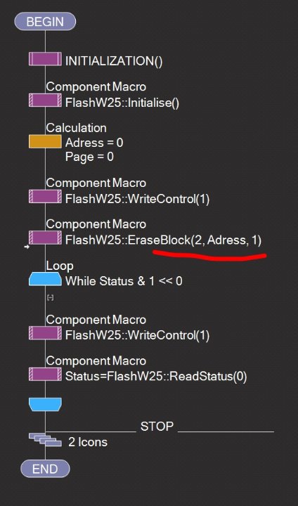

Erasing the entire block doesn't work either
Prog.fcfx
Prog
(23.46 KiB) Downloaded 553 times
Prot
Prot
Flow
Flow

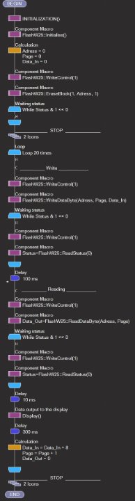

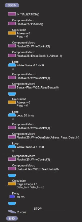

20 write / read iterations also works
Program.fcfx
Program
(28.44 KiB) Downloaded 625 times
Prot
Prot
Flow
Flow
