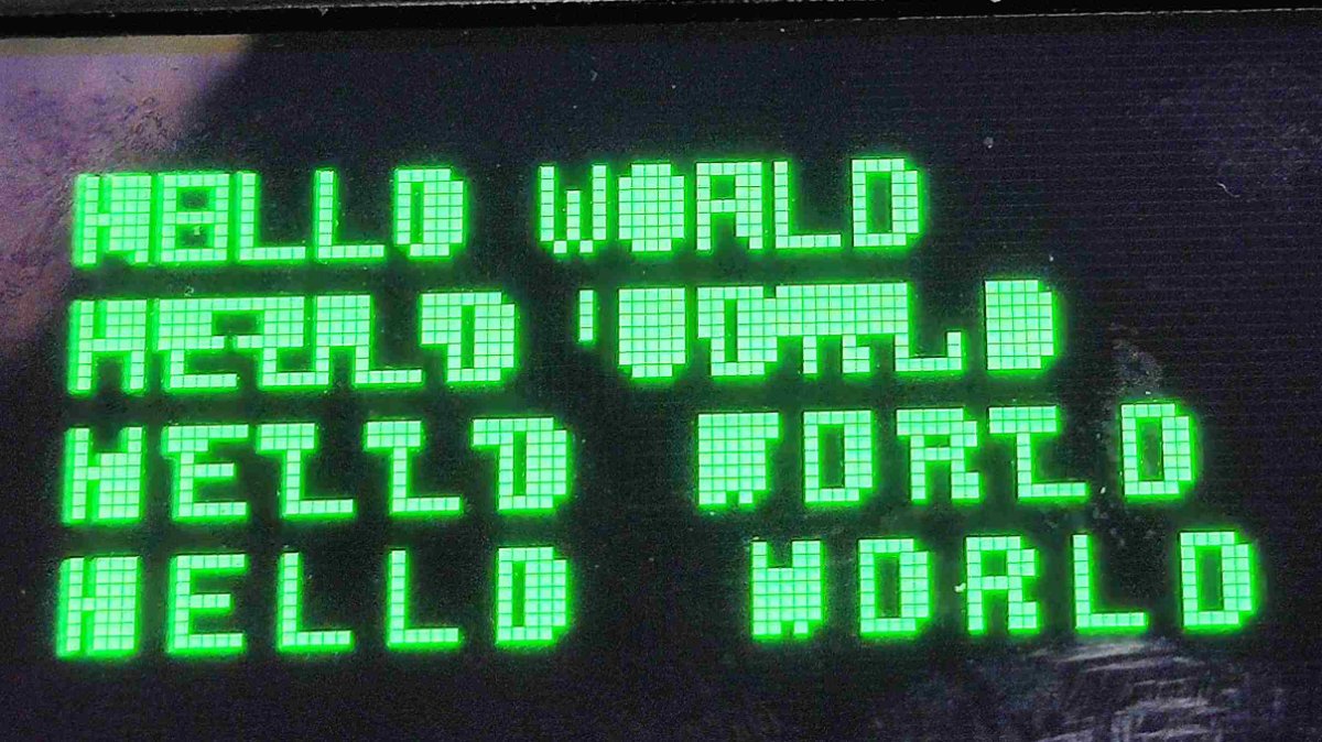

The skipping must be something to do with flowcode , a colleague has used an identical display with the arduino library and he gets text as shown in attached image. I have tried all the fonts, sizes and options to no avail.

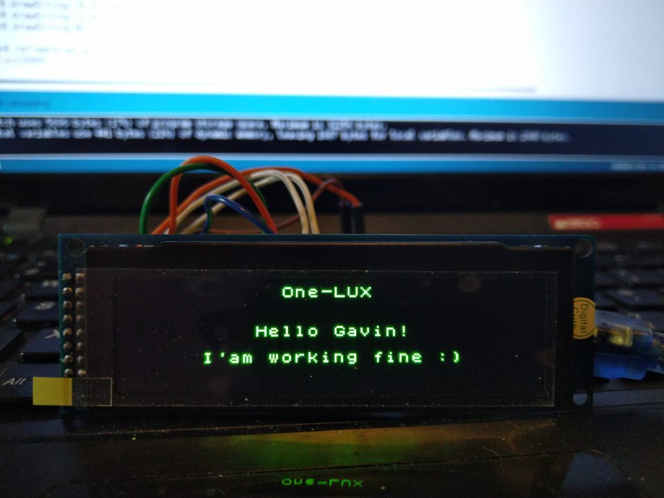

Just to let you know I have had a colleague connect the ssd1322 display to an Arduino setup and it works fine as shown in attached image.
As this was done without flowcode, it suggests the problem is with the flowcode component

Re: SSD1322
For some reason it's not displaying text correctly see attached image

Re: SSD1322
Many thanks for letting us know.
I've put my display into 3-wire SPI mode now and have replicated the issue. Hopefully have a fix for you very shortly.

Re: SSD1322
Hopefully sorted for you now.
