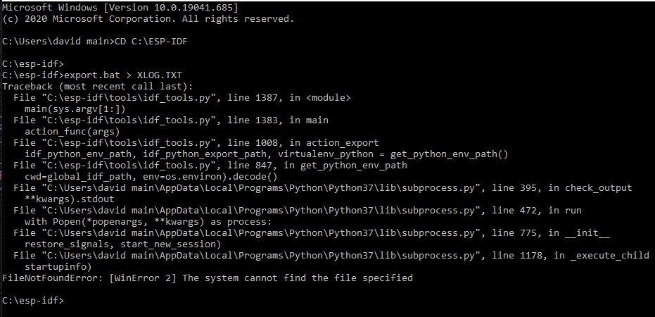

Re: ESP32 not compling to chip
hI
Sorry ignore last reply as still had set using idf prompt
Have re run again with a clean prompt and ZIP file of the command response
- Capture_prompt.GIF (29.69 KiB) Viewed 14337 times
LeighM
- Posts: 558
- Joined: Mon Dec 07, 2020 1:00 pm
- Has thanked: 110 times
- Been thanked: 302 times
Thanks.
Based on that I think the issues are related to the user "david main" and the space.
Is it possible for you to create a new user on the PC without a space in the name,
then try a re-install of the Espressif installer
