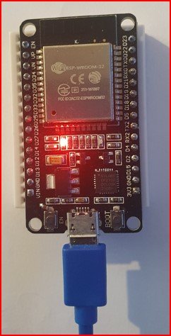

HI kersing
Unit: ESP32 DEUKITU1
See the device connection below in the picture:
Enhed ESP-IDF.jpg (26.66 KiB) Viewed 4066 times
Hope you can see how the ESP-IDF unit is connected :idea:

Posts: 2093
Has thanked: 163 times
Been thanked: 960 times
Re: Flowcosev10
Post by mnfisher »
Try using the esp32 wroom-32 settings in FC - from the stamp on the board looks like it could need this (not sure how much they differ though)
monie
Posts: 73
Joined: Wed Oct 19, 2022 4:06 pm
Has thanked: 1 time
Re: Flowcosev10
Post by monie »
HI mnfisher
I have tried to using the esp32 wroom-32 settings, but without success....?
Monie
Posts: 2093
Re: Flowcosev10
Post by mnfisher »
Which bit didn't work? Did it upload and nothing happen or upload fault?
Can you 'connect' to the esp using putty or the serial in Arduino ide and see if it outputs anything?
