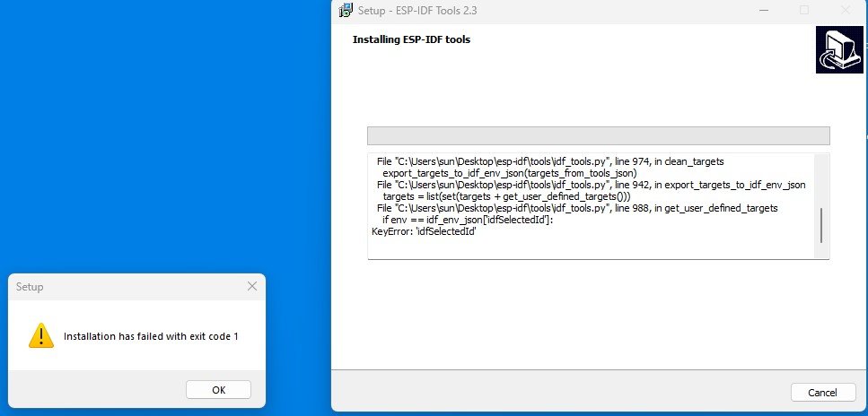

Hi mnfisher
Look here:
Installations ha failed with exit code 1.jpg (43.22 KiB) Viewed 4580 times

Hi Monie,
Odd - you have Setup - ESP-IDF Tools 2.3 and a directory of c:\users\sun\desktop.....
Maybe an old version on your machine running instead?
In the video (sorry it's a bit fuzzy) - it is definitely v4. so something is not right.
It is definitely worth trying to install in c:\espressif - the default? It might use the path of an 'existing' install if there is one. Have you tried uninstalling everything (Start->Add or Remove programs) ?

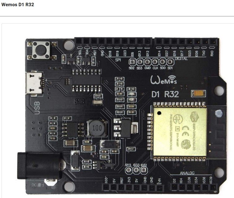

pins: Esp32 Ch340g Wemos Board Uno R3 D1 R32 and TFT SPI ILI9341
ESP32 Wemos Board Uno R3 D1 R32.jpg (94.24 KiB) Viewed 4526 times
Would you be helpful with SPI ILI9341 about which pen need to Esp32 Wemos Board Uno R3 D1 R32 to be used Display.
The connections are not specified here MOSI = A26 0g MISO = A25 etc.
Where Esp32 Wemos Board Uno is listed as IO18 and IO19 etc.

Post by mnfisher »
If the board is compatible with Arduino d13 is SCLK d12 is MISO, d11 is MOSI and D10 (usually CS) these are labelled on the board as : 18, 19, 23 and 5 respectively - so try those first.
The board maybe doesn't break out all the I/O pins.
There is a pin diagram at https://www.botnroll.com/en/esp/3639-we ... inout.html
