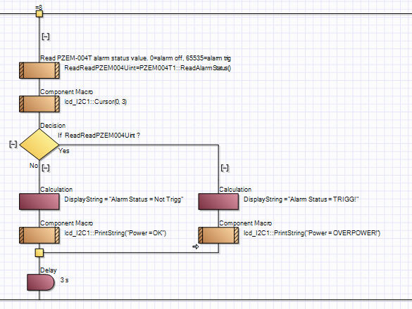

As for the display showing over power and the UART wording remaining the same how about:
PZEM-004T Overpower.png (46.25 KiB) Viewed 5882 times

I added the Alarm Threshold Level (W) to properties to make it easier to set any value.
Alarm Threshold Level Properties.png (6.03 KiB) Viewed 5880 times
Of course, you can enter a value directly within the SetPowerThresholdLevel function

Thank you. Concerning the overpower Good idea, and when the module is connected and some value is come in, there is less digit. Alarm threshold setting in properties, very nice, so this give the next question :D what alarm is comming, in the display or is it possible to set an output?

jgu1 wrote:
Mon Jul 24, 2023 6:59 pm
You can place an output high within the Yes branch of If:ReadReadPZEM004Uint decision icon and an output low within the No branch.
