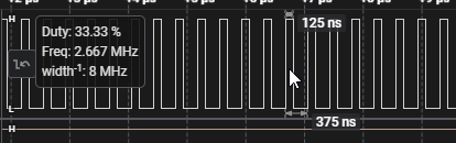

I changed the settings of the PWM of SpeedCheck3 and the highest frequency I can get is 2.7 Mhz
That would be impossible if the osc is running at 500kHz.

The chip is running at a rate of 8 million instructions pre second and the output pin is toggling at 500KHz, that seems about right to me. That equates to 16 instructions for your loop which also seems about correct. A jump instruction is at least 2 instructions and so the loop is two instructions and the if is two instructions. The output icon will do things like setting the data direction register as well as pushing and popping the stack. You are also likely using the free unoptimised version of the XC8 compiler which likes to add meaningless nops into the assembler code.

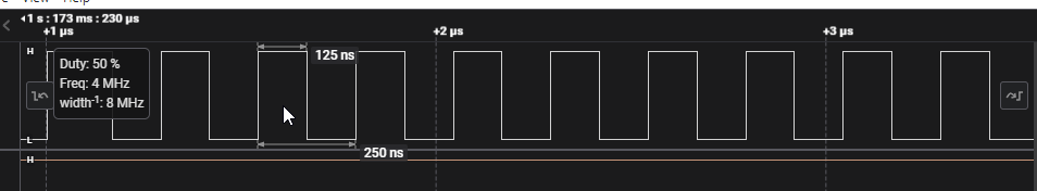

Attached is the best I can do.
It's a PWM of 4MHz.

You won't have much control over duty.
