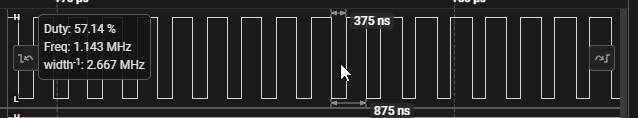

What do you mean by only works at 500kHz? - A PIC running at 32MHz has an instruction rate of 8MHz - so 16 instructions per loop / output to pins and change the value of clk.
It's probably about right?
The 'fastest' I can get on a 32MHz PIC by toggling a pin (A0) is 1.14MHz (with 540ns / 340ns high / low pulses) - you can get faster using PWM if you need?
AVR chips are quicker at 1clk per instruction - so 16MHz chip gives 16MHz instructions.
Note - I cheat and use an output to A0 to set it as an output (rather than fiddling with TRISA etc).
(Sorry - had to change the chip)

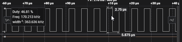

Have you tried the one sec flash test to check if your hardware is running at the correct speed?
I have just tried your configuration settings with Martins method of toggling the A0 pin on a 16F1825 and: Using your flowchart with the same configuration, the toggle speed is: All the overheads slow things down and that is what you are seeing.
The 1sec flash test working as expected, so no configuration issues.
As it is not a bug, I have moved the topic to a more appropriate section.
Re: PIC16F1825 Bug in OSCCON
Hello Martin,
It must be a bug. It cannot be that with a clock frequency of 8 Mhz with the program with PWM an output frequency of 10 Khz results. With the second flash the process can always rest 1 second. This is not meaningful. I need continuous calculations which are not possible. Please check the signals with proper hardware frequency counters or oscilloscope. Also when I implement midi and there comes a midi sequence with 3 or more commands, there are errors because the program is too slow. A 16F688 with 20 Mhz crystal program written in assembler is able to reach a 4 Mhz signal. Also if I implement midi and there comes a midi sequence with 3 or more commands, there are errors because the program is too slow.Please check the signals with proper hardware frequency counters or oscilloscope. A 16F688 with 20 Mhz crystal program written in assembler is able to reach a 4 Mhz signal.
The slow speed is now clear to me. See this post.
https://flowcode.co.uk/forums/viewtopic.php?f=5&t=2010
Please check the matter.
Dirk
