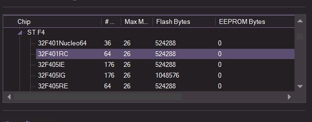

Hi I also managed to find that file by doing a search and edit it
also changed the ram value as it was 98K
But still in flowcode dose not change .
flash .jpg (21.72 KiB) Viewed 8729 times
I think you will need to do it via an Library update

I don't think that list comes from the fcd.
It will be worth trying your modified version anyway.

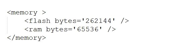

Hi , is the memory part i was talking about in the section below that
it is not correct , should be flash bytes = 262144 & ram = 65536 .
    <memory >
        <flash bytes='524288' />
        <ram bytes='98304' />
    </memory>
