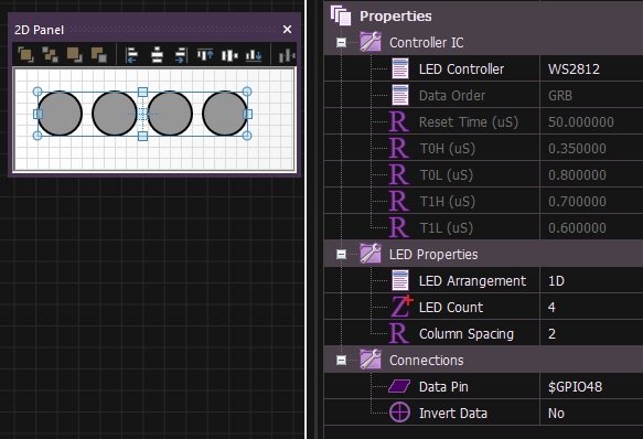

I have made test. Full update. No changes for me. I use the ESP32 S3 DEV board. I use the pin 48 which is connected to the onboard WS2812 Led.
No data is comming out of pin 48.
When I add the WS2812 the "led" shown as in the picture on the 2D screen. Maybe I have overseen something. :?:
Br Jorgen

Have you had time to look into the WS28xx component? As you can see, in FC11 the LEDs do not resemble the actual LEDs as intended. In FC10 they are displayed correctly in the 3D panel, whereas in FC11 they are shown in the 2D panel, appear as square, and do not work in the simulation.
I test with the ESP32 s3 dev board, the led on the pcb.
Thank you in advance. ;)
Br Jorgen

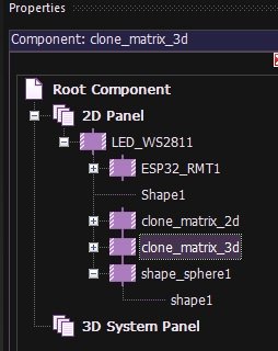

Just checking but have you done a full database update, it could be something underlying like the clone matrix is missing.
The latest version of the component should be able to be added to both the 3D panel and the 2D panel. You should be able to right click the component on the toolbar and choose where it is added.
As a check can you click on View -> Component Debugger and then check the Expose Full Component tree.
In the properties pane your tree should look like this.

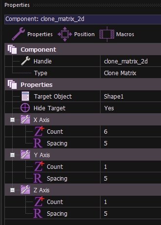

Also check that the clone_matrix_2d has properties that look like this.
This is what I'm seeing so be useful to find out what's different for you.

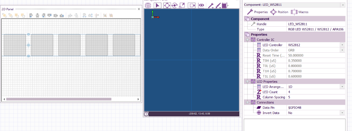

After I have restart FC I could see the Led on 2d and I can simulale, but not working in ESP32 s3 HW. If I add a new WS28xx ,they are squared again.
In the Proporties, hsndle the component name is WS23111.
Jorgen
