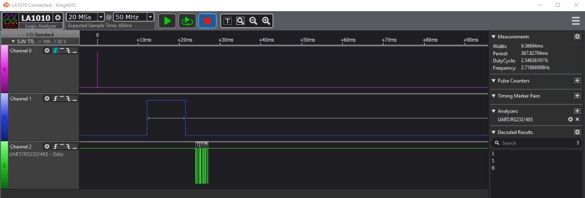

This time I used the same setup as documented in the above posts but using software mode with the following results
Measured (cm) / Displayed (cm) / Pulse Width (mS)
109 / 78 / 6.27462
120 / 86 / 6.9197
140 / 100 / 8.0691
144 / 103 / 8.32248
162 / 116 / 9.3676
I have only attached the shot from 162

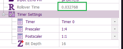

I have just looked into this, and its not a bug but a setting in which I gave incorrect advice.
What I have done is exposed the timer rollover time which is in seconds
The furthest distance that can be measured is 310 cm = 18ms.
Therefore, the value exposed can't be below the maximum ms time.
If using a clock speed of 32MHz, then you will need to set the prescaler to 1:4. That gives a maximum time of 32ms which is ample.
Rollover time needs to be a low as possible but higher than the ms max distance time (e.g 18ms).
To try the component.
Place the attached component.
C:\ProgramData\MatrixTSL\FlowcodeV10\ComponentsIf Flowcode is already open, then you will need to reload your project for the new component to work

Just did a quick test, not much time. Downloaded and set Prescaler 1:4
Measured (cm) / Read (cm)
162 / 160
187 / 180
213 / 211
Looking very good so far...
I'll do some more tests later but things seem sorted now.
Thanks again.
