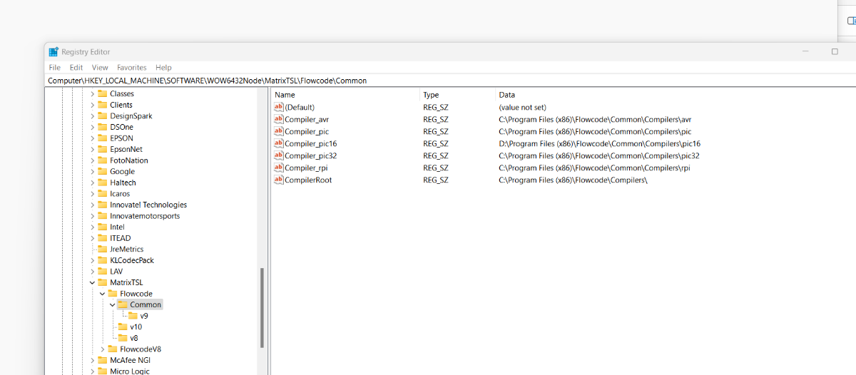

I cannot compile to HEX. The message is cannot find file. I can see the file in the directory. It has a V10 symbol next to it is that the problem? I have added image of registry

cannot complie to HEX after installing V10 Paid licence
rsbake24ja
- Posts: 8
- Joined: Fri Dec 18, 2020 4:14 am
Re: cannot complie to HEX after installing V10 Paid licence
- screen shot registry.png (139.59 KiB) Viewed 3318 times

It seems that v8 is now finding the toolchain location but is failing to launch the appropriate file.
There are a few posts in the old forums that may help. For example, this one seems to offer a solution:
https://www.flowcode.co.uk/mmforums/view ... 658#p90658

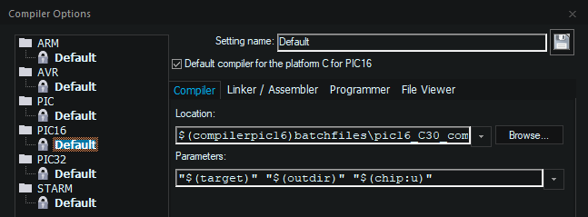

On my PC the toolchain appears to work ok. My Compiler Option settings are in the image below:
And I have checked the location of the toolchain and it does contain the "batchfiles\pic16_C30_comp.bat" file, which has the following contents:
Please check to see if these are the same on your PC.
Hi Steve
Sorry the delay. Yes my batch file matches what you have as shown below .
I was tinkering with the idea of pulling v8 from the machine and reinstalling on the machines D drive next to v10.
Both compilers on v8 and v10 are working ok for 8 bit chips.
