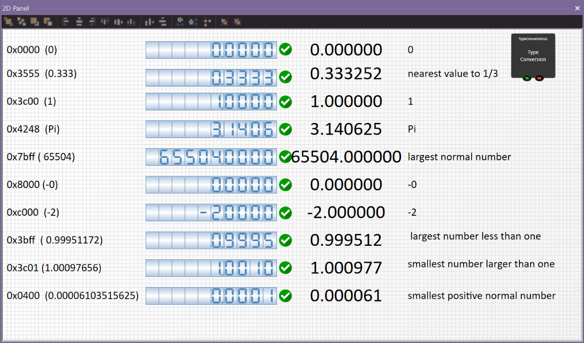

Hi Martin, Hi Steve
I have added Martin's macro to my program. It works perfectly in the App. Very good, thank you Martin.
App:
FP16_to_dez_App_post1.fcsx
(90.91 KiB) Downloaded 405 times
Result:
Posts: 2185
Has thanked: 177 times
Been thanked: 1026 times
Re: TypeConversions from FP16 to FP
Post by mnfisher »
Cool!
Should be easy to look up the bit patterns for NaN and +/- infinity and add those too for completion.
