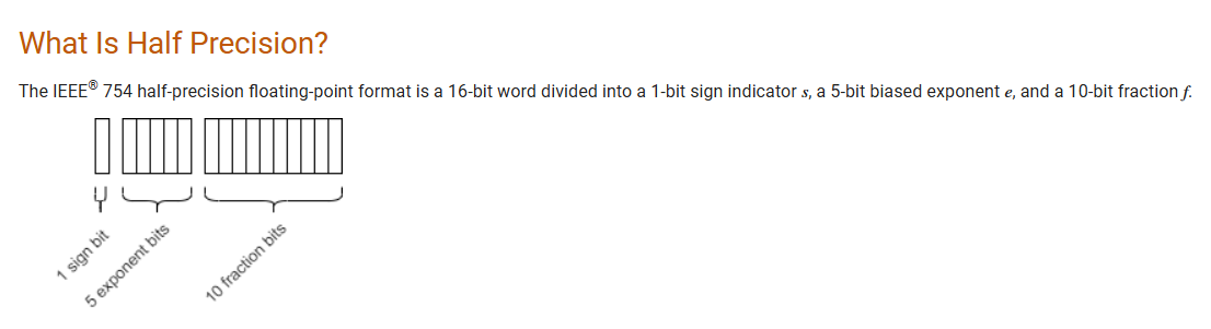

I read from an IMU values in the format FP16.
I store them as 16bit integer.
There is a practical and useful component to convert types.
Maybe you can add an input to read FP16 and get it as a floating point from Flowcode (is a FP32 ? )
Half precision floating-point

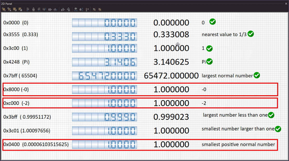

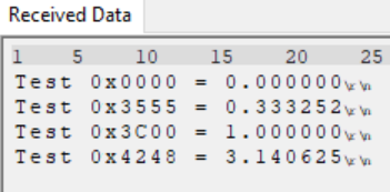

As it stands it tests three numbers (from https://en.wikipedia.org/wiki/Half-prec ... int_format )
These are output to UART (and seem correct :-) )

Yes Martin, the result are perfect!
UART:

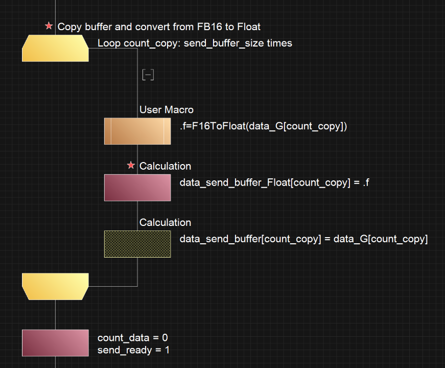

Hi Martin, Hi Ben
It is simply converting and saving to an array, perfect!

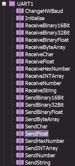

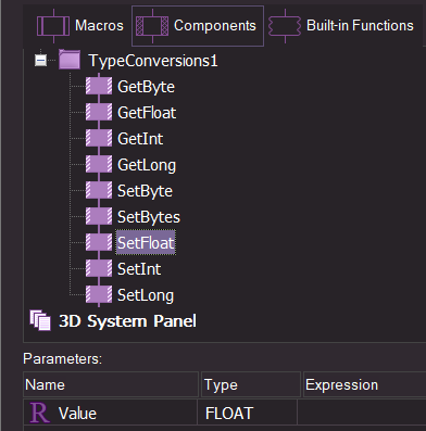

but it is not possible to send as Float_Array.
Receiving in the app is also not possible, only as INT_Array.
And if I send the values as a Float instead of FB16, I send twice as many bytes.
Question: can I also do the conversion from FP16 to Float in the app?
and also add a send/receive Float_Array?
no send Float Array available:
simply converting and saving to an Float_Array:

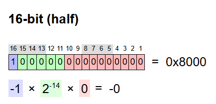

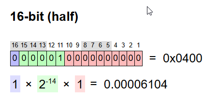

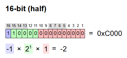

I have tried to make a macro for the conversion FP16 to FP32 that works in emdeded and in the App.
I tested different values and it works. But three values don't work. Do you have an idea?
My App with the macro:
FP16_to_dez_App_post1.fcsx
(85.58 KiB) Downloaded 274 times
This link was helpfull:
https://evanw.github.io/float-toy/
https://en.wikipedia.org/wiki/Half-pre ... nt_format
And....
The problem:
