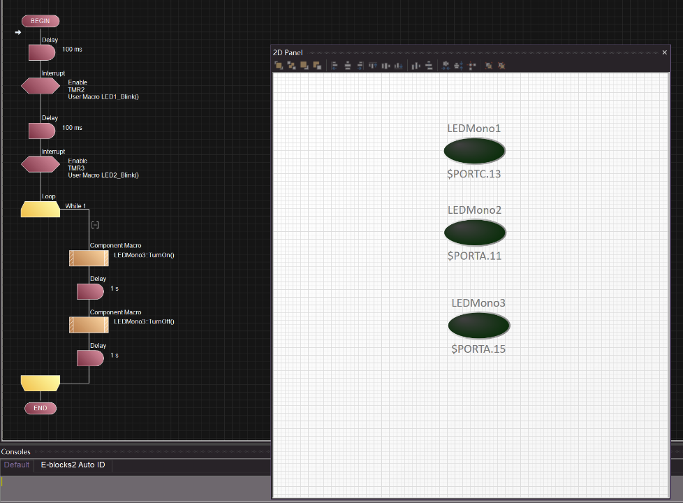

For your suggestion, I have add the delay:
1, 10ms before all the interrupts
2, 50ms before all the interrupts
3,100ms before all the interrupts
4,100ms before each the interrupts
Looks no different. it didn't help.
Br, Deqiang

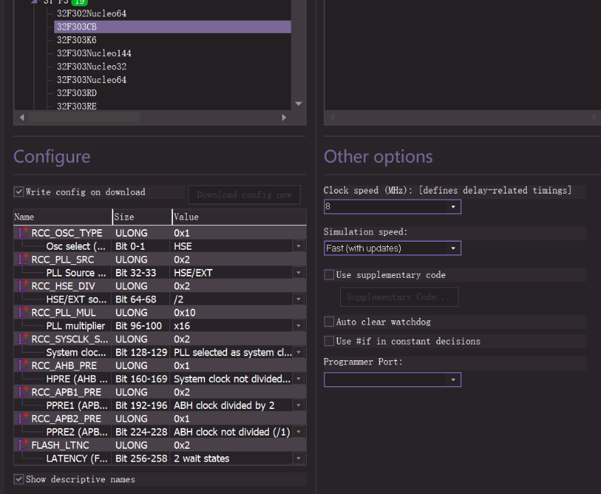

I've bought an STM32F303 development board to play with.
I've not had any issues with the timer interrupt.
However, my testing has thrown up an issue with the 32F303CB FCD, the config section is missing the HSE source divider parameter.
This means it would be easy to accidentally overclock the device.
I've attached an updated FCD that goes into directory C:\ProgramData\MatrixTSL\FlowcodeV10\FCD\ARM if you want to give this a test. This FCD adds the HSE divider.
If you use this FCD with your existing projects you will need to carefully reset all the config parameters (as the old parameter/value pairs will be out of step).
If you now compare running HSI versus HSE, I suggest you set the HSE source divider to /2, that will then mean HSI and HSE settings will be equivalent.
If all goes well Matrix can merge this change back into the repo.

Sorry for late reply. I was out of office during last week.
I have download your fcdx file and replace it. and set the HSE source divider to /2 as what you mentioned. the final HCLK is 64 MHz.
It works fine!! Also works after restart or power off and on.
So it means what you found about the issue was correct!
Thank you very much, hope this issue can be fixed about other related chips.
