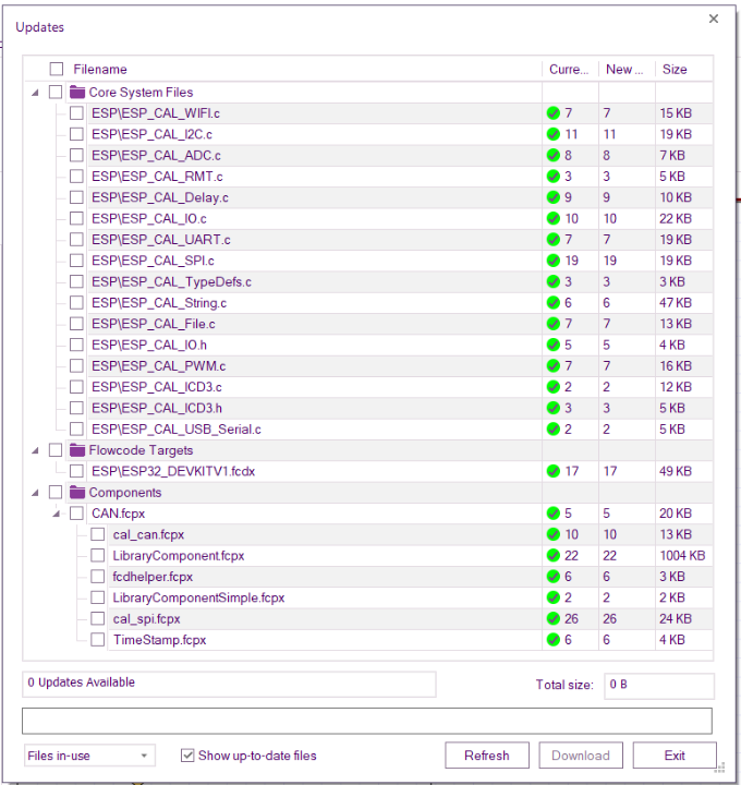

The only thing you should need to do is to use the library updates tool from the help menu. This should give you the latest can driver that should allow internal can to compile.

That i have done (more than ones
) plus clean new install and its showing these versions for ESP (screenshot in attachments).
still compiling with 'can.h" build failed.

- ESP ver.png (154.21 KiB) Viewed 3794 times

Ok that's odd, I've pushed the change to the update system again.
Re: ESP CANbus not compiling
YES!
'Build completed sucsessfully'
Back to creating CAN signals ! i'l test asap.
Thank you Ben.
