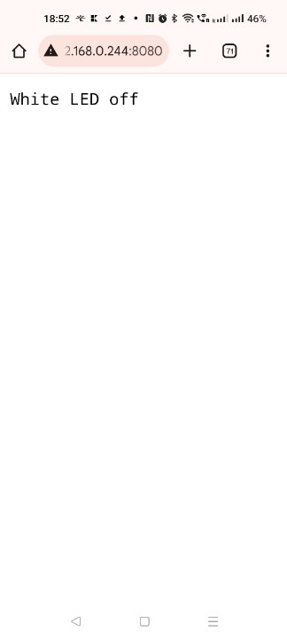

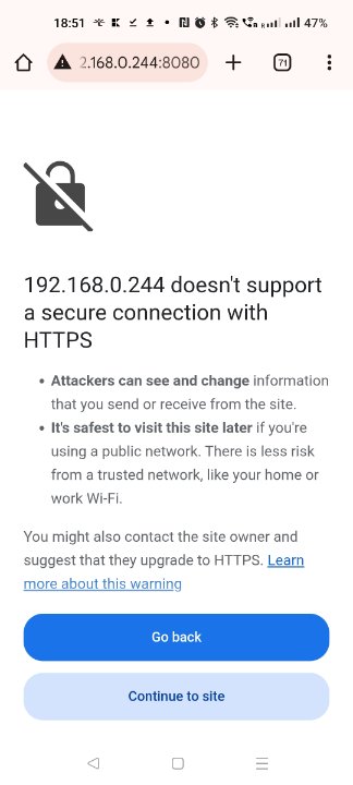

I have an update
If I type the command in the address bar of Chrome, 192.168.0.244:8080/aoff , a pop up window appears telling me that this address doesn't support a secure connection with HTTPS and it will give me two options, Go Back or Continue.
If I choose Continue then the command is being sent and the page will display the answer sent from ESP32.
This conclude that the communication between phone ( Chrome browser) and ESP32 are working. The problem must be in the WebApp code and I have no idea where.
- Screenshot_2026-01-03-18-51-37-58_40deb401b9ffe8e1df2f1cc5ba480b12.jpg (35.31 KiB) Viewed 4860 times
- Screenshot_2026-01-03-18-52-06-85_40deb401b9ffe8e1df2f1cc5ba480b12.jpg (9.6 KiB) Viewed 4860 times
