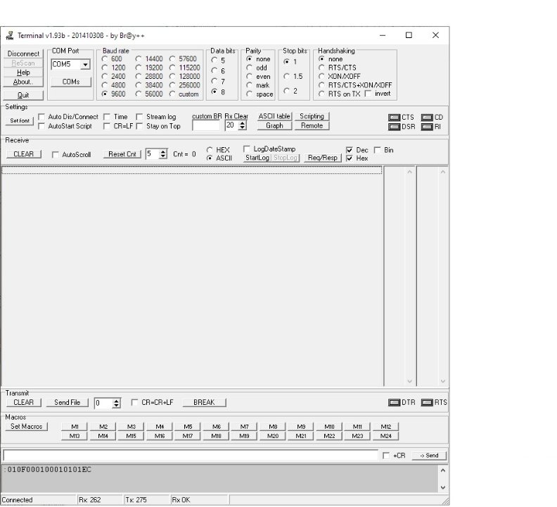

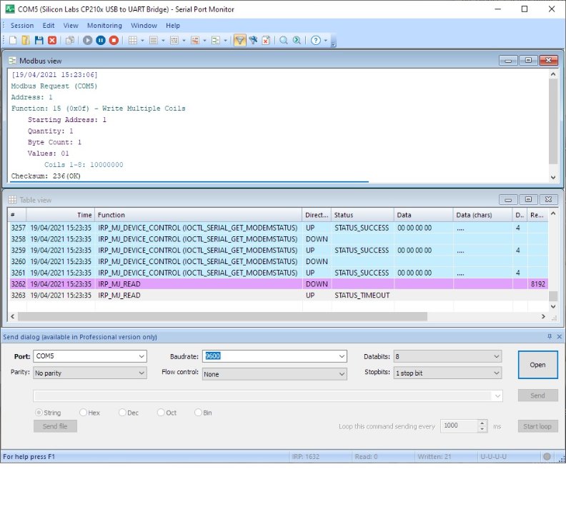

here is the program, practically the same as the example from which I removed the LEDs, and a photo of the message sent to which no response follows.
- MB_tr.jpg (64.42 KiB) Viewed 9205 times
- MB_ric.jpg (91.58 KiB) Viewed 9205 times
- test_MB_ASCII.fcfx
- (12.86 KiB) Downloaded 706 times

Re: ESP32 MODBUS ASCII
even this has no answer
Are you sure it's MODbus ASCII the PC application is using?
The default is usually Modbus RTU and looking at the data it does seem to be RTU.
unfortunately the request is ASCII, I tried to compile RTU (for test), but the result does not change ..
