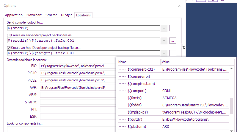

Regarding the original problem, it looks like the setting for the port is missing. The "project options" screen will show the first com port in the "programmer port" drop down as a default, but there is a bug where this is not actually set.
To ensure the com port is set correctly, open "project options", then click the drop-down and select the appropriate com port in the list (even if it seems already selected) and then click ok. Then save your project. At this point, the com port should definitely be selected and should also be saved in the project fcfx file. You can check this is the case by opening the "global settings" screen, and clicking on a dropdown in the "Locations" tab as shown in the screenshot below.

the trick works also for me and now i have programming chip.... but i have noted that before $(comport) in compiler option seem lack a " or i wrong?

Glad to hear you have it working.
The quotes are not needed in the case of the COM port because it does not contain a space
