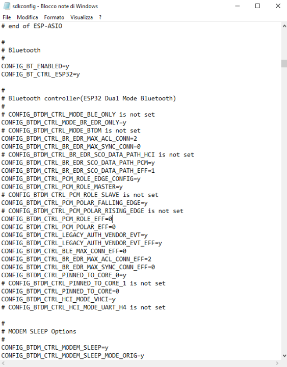

sorry, but where did you find your "esp32s_sdkconfig" file? is it inside
"C: \ ProgramData \ MatrixTSL \ FlowcodeV9 \ FCD \ ESP \ Batch"?
because mine is totally different. I attact the file in txt format

Yes that's the place and yes the file there looks different.
For your first time bluetooth better change the sdkconfig file in the project folder.
You can also post this file as .txt and will have a look if I can change it and post it again for you.

finally I understood how to navigate through the folders and modify the "sdkconfig" file of the project with "idf.py menuconfig", only with this method the "sdkconfig" file is not overwritten, if I directly modified the "sdkconfig" file with notepad, when I compiled, the file was overwritten. I made the same changes as you. Unfortunately I can't program, the programming starts but then aborts.
were you able to program with this file?
I attact file

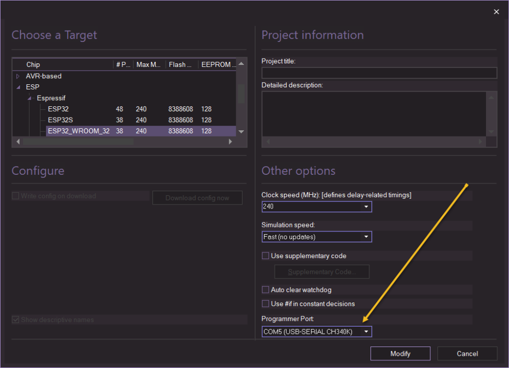

And can you check in the project option if your programmer port is there.

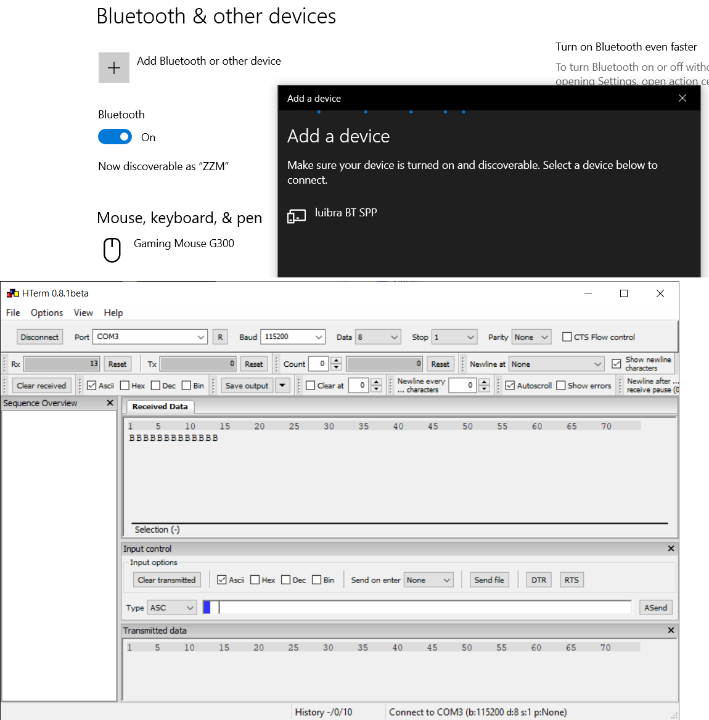

A big THANK YOU, now my program works too, it was necessary to delete all the folders inside the project, recompile and edit the "sdkconfig" file again as indicated by you. Now I finally see that it works. THANK YOU again for your patience.

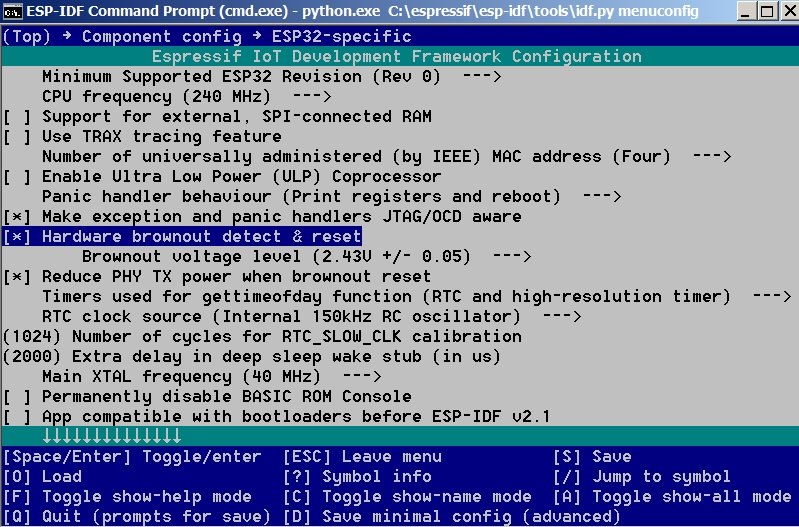

For whom it may concern: the brownout settings are located here =>
Component config -> ESP-specific -> Hardware brownout detect & reset...
