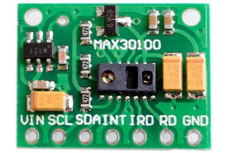

I was change MAX30100 module because it works with +5v, with another (CJMCU-30100), more compatible with TX pcb..that has Vd=3.3V.

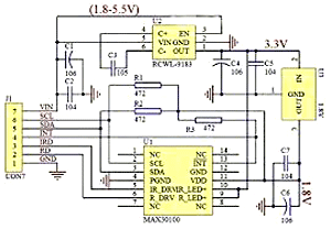

unfortunately I had same result...no data (0,0)..in module schematic, I note that SCL, SDA are in 1,8V level, because Vd of MAX30100 is 1.8V.
is that compatible with 3.3V of sender? can I pull SCL, SDA with Vin? that module is referred that works with arduino in +3.3V , but I wasn't tested. about INTERUPT pin I don't see a connection in properties.

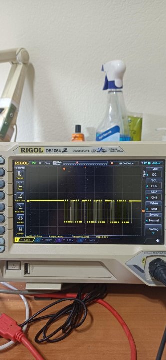

SDA in oscilloscope , after pulling up ..it seems that FC don't see or don't get values in data...there is no delay in data at terminal...

- Posts: 2124
- Has thanked: 474 times
- Been thanked: 705 times
Re: PIC18F25K22 UART ERROR
Just a quick thought (and I haven't checked myself) but you mentioned that you are now using a different module. Does it have the same address as the component is looking for?

- Posts: 2124
Did the old Oximeter ever give you a reading in Hardware?
Are you running your PIC at 3.3v too or is it still at 5v?
Are both I2C lines showing activity? Does the Oximeter give any response at all?
It's not uncommon for "clone" hardware to use a different address to the original, which is why I suggested checking with Medelec35's sniffer. You can find a link in this post
viewtopic.php?p=3445#p3445
Run this (change to PIC or the like) with your Oximeter connected and it should tell you the address it is using. If not then there is a connection problem.
