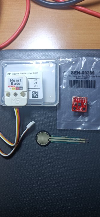

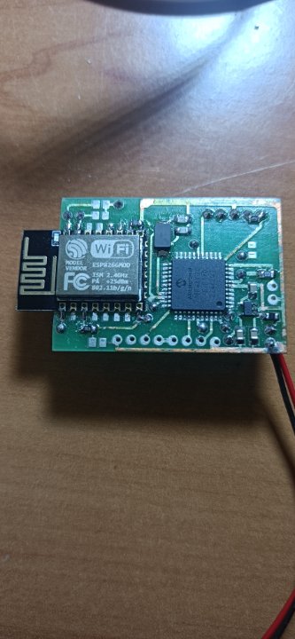

the codes for 2 PIC that controls 2 ESP8266 runs ok..data are recorded well in Excel with Data Streamer..
PIC18F46K22 controls first ESP8266, gets data from sensors , is set as client (STA), and send data with wifi to second ESP...PIC18F25K22 controls second ESP , gets sensors data from first ESP , is set as server (AP), and send data to pc..the only that need the set of codes, is the kind of variables that holds sensors data...

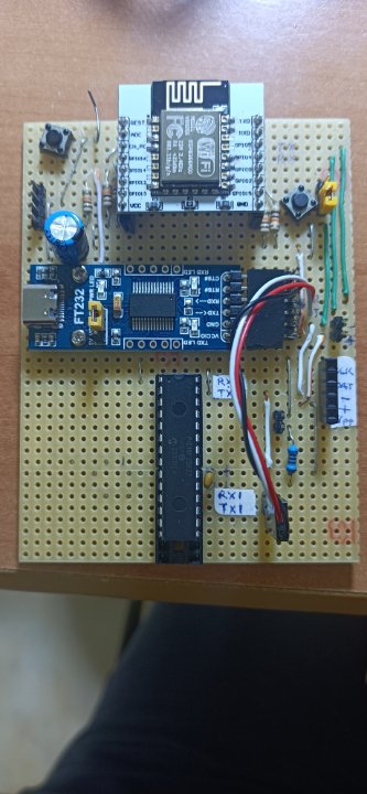

Hi and thanks for help.
I've tested the hardware... 2 boards are ok. the receiver board with second ESP + PIC18F25K22 is connected with serial/USB module (FT232) to PC..communication between PIC and PC is ok.. I've tested with a demo code..PIC has 2 uarts.. uart1 is connected to module, uart2 is connected with RX/TX to ESP.. I don't know if that will works, but I think that there is no communication between 2 ESP. . ret var is 0 ..something in two codes is missing or it is wrong in section of sending and receiving of data...there is no problem with sending data to excel, not to collect data from sensors..in simulator, string variable of sensors data is ok .I use RealTerm and PuTTY to check the received data but there is no data.. I can't find an example on how can connect 2 ESP with wifi, and send/receive data..only at arduino, that I can't use, because of small space of mobile board..I made some corrections in codes with no result..

Below are some photo of hardware and sensors to take a look...I'll continue to try to find errors , or to use another component...I was added a force sensor (FSR).

My 8266's are a bit more basic than yours appear to be
I don't think the sensors are of any issue as I'm sure the interfacing will be straight forward.
What distance do you need to communicate over? I ask as I recently made a transparent Bluetooth link that would do as you require.
https://www.flowcode.co.uk/mmforums/vie ... 68&t=23028
I should get time to look at the ESPs in a day or so.
