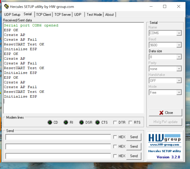

I've made a hardware copy of sender/receiver to continue tests for adding more transmitters..hardware/charts are the same as prototype but receiver don't create AP...what is the reason for that ?

Re: PIC18F25K22 UART ERROR
As mentioned earlier, the Component Macro when initialising looks for a different response than what the ESP returns so will always "fail". Therefore if using the Component Macros rather than "AT" commands, we need to ignore the "return" value when initialising. This means we don't actually know whether or not we have successfully initialised.
In the chart we assume we have and move on. The next interaction is when we create the AP and we can then check if successful. If so we move on, if not we reset.
Clearly from the above the ESP fails to create and resets.
If you haven't changed anything in the chart then I would strongly advise checking your connections to the ESP and associated settings.
If you post the chart you are using I can have a look in case anything is wrong.

I was made some changes in delays..connections seems ok...maybe there is something wrong in hardware.
I would like to check the chart first..
I don't see anything untoward, so I would double check connections. Although in saying that it is Good Friday and I'm about to go out and make it a Great Friday
If you connect your USB-Serial Rx to the ESP Tx (@115200) you should see an "echo" of commands being sent by the PIC. If you get nothing they definitely are not talking to each other.
the problem was in ESP...I was changed with a new and now I have "waiting for Data"..now I'll make some transmitters to test if receiver can get data from more than one senders.
