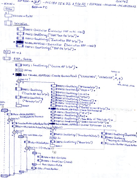

Nothing needs done in Rx as it simply passes on whatever is received to Excel. Now, the data Excel receives will start with the ID (1,x,y,z etc).

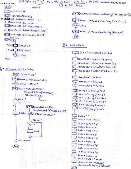

I had made a sketch for 2 codes, long time ago. I send you a copy for sender-receiver in case that you have no access to flowcode. Would you like to note in the codes the modifications , to have data from 2 senders in sequence to one receiver ? thanks.

Both transmitters are exactly the same, we just add in the unique "ID" when you code. We create a new string variable called ID (or even Tx if you want) and this value is different for each transmitter.
For transmitter-1, you could have ID="1" and for transmitter-2 ID="2"
When you build your send string, which from above is called data, we would now have
Data = "" this clears the string for new values
Data = Data + ID this adds the ID to the string, now data=1
Data=Data + "," this adds in a comma to separate the values. Now data = 1,
Data = Data + force
etc
etc
