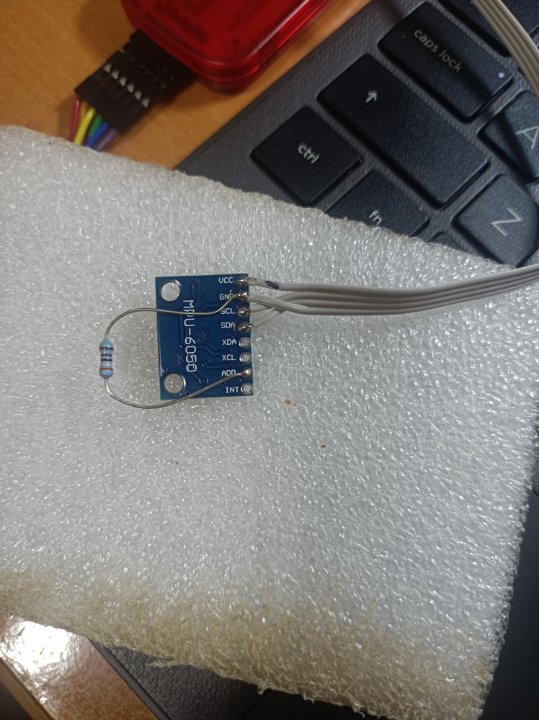

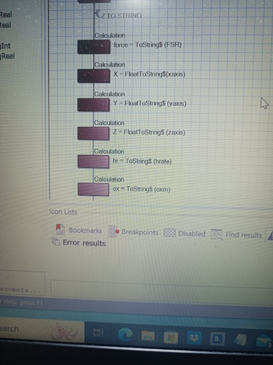

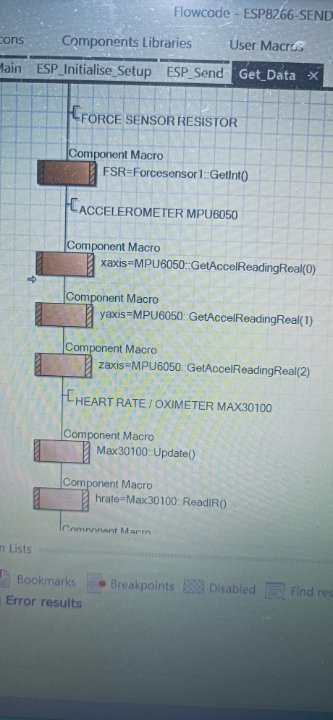

Now , I've made some tests with another accelerometer sensor a module with MPU6050 , but I have no data ...Is something wrong at the code for that module?...connections are correct , AD0 is connected to GND with 4.7K resistor...
MPU6050 Initialise is set at Main, instead of MMA8452.
It was easy to have a range of 45m ...With careful design of transmitter PCB , 50m range it's possible with PCB antenna .

Most likely there is some issue with the 6050 code. Do you have a link to the module you are using? I might have one somewhere so will try and have a look.

I've just looked at your pictures above of your chart and it looks like you have forgotten to sample the sensor before you read values.
If you include the component macro SampleDevice before you use the "GetAccelReadingReal"" macro's you should get returns.

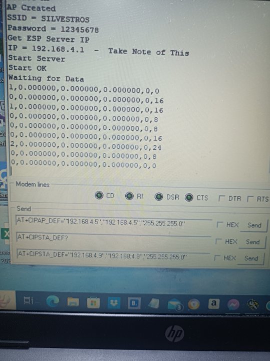

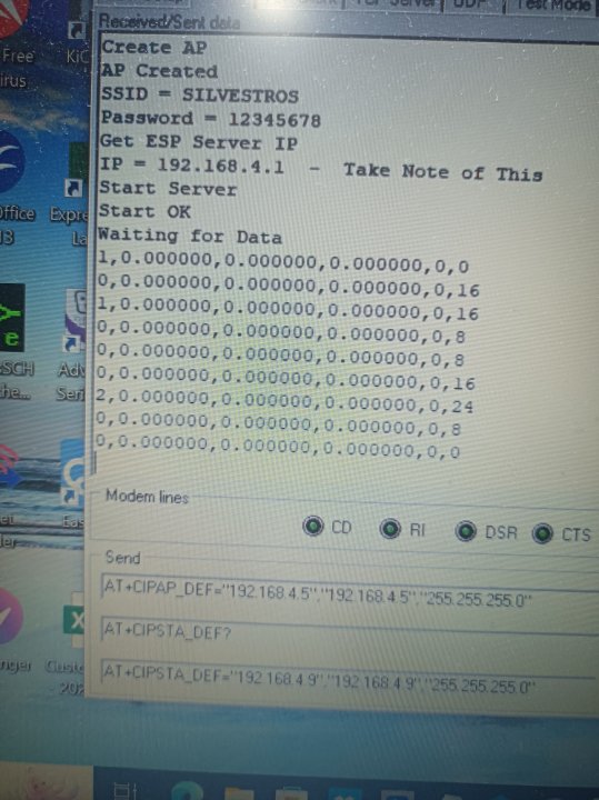

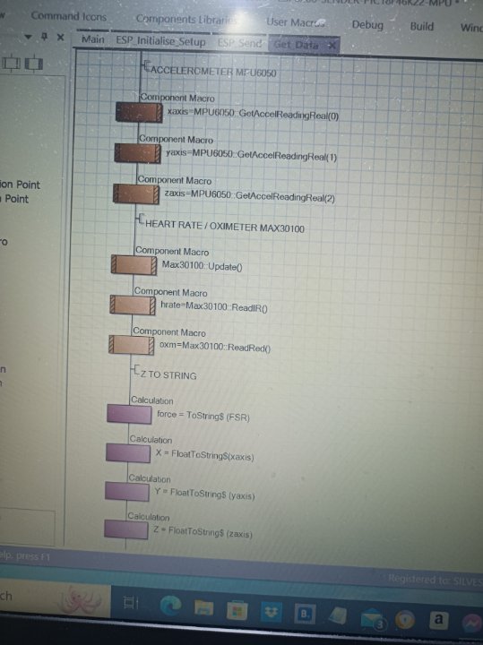

I was added MPU-6050 SampleDevice , but I have no data. In simulation , preset values of X,Y,Z reset to 0 in Debug Run.
Is there something wrong with MPU-6050 component or with device address ? In Properties I set AddressBit to 0.

With AD0 connected to Ground the module should then be set for address 0x68 (or if connected to +v 0x69).
I've just tried simulating an example file I downloaded a while back (possibly when using v8) and it didn't simulate. I then created a new chart in v10 with just the component reading Gyro, Accel XYZ and temperature and it appears there is an issue or two when simulating.
Irrespective of what the temperature is set at, it always returns 36.
The GetAccelReadingReal doesn't appear to work at all, and whilst the GetAccelReading does provide a return it is nothing like the scale values.
If I get a chance I'll try in hardware too, but at present it looks like a component issue (well at least if simulating).
