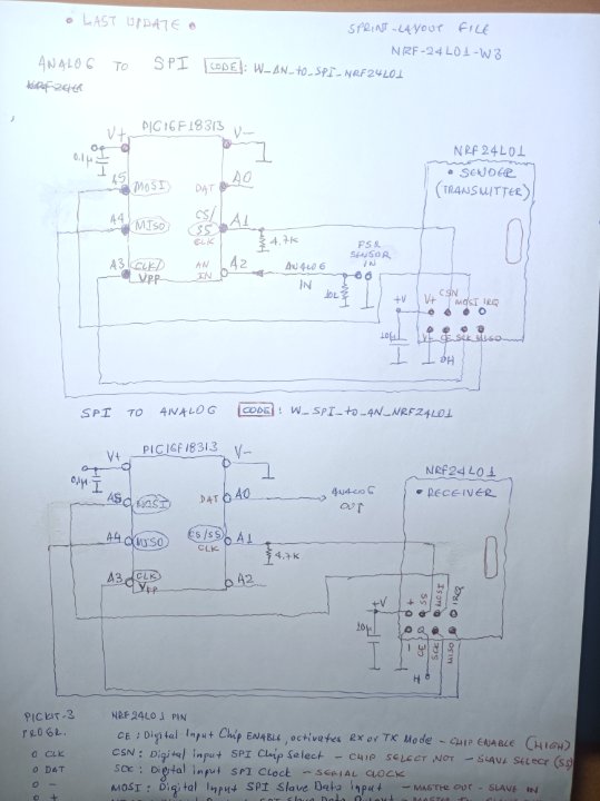

Not had a chance to look at your code yet but I should have a couple of the transceiver modules somewhere. If I remember correctly, most problems with these type of modules are related to very poor build quality.
Adding an antenna appears to help whilst in other cases adding in capacitors improves performance. It seems you get what you pay for with these. Cheap doesn't mean better.
My modules have an SMA connector with a little antenna and again if I remember correctly worked fine in my "evil lab" but I've not done any range tests or anything. I can't remember when or why I got them but guess it was for some test or another. Doubt if I have still have any code as I can't really remember much other than they "worked" for whatever it was.
However if I can get them talking again it may help with your project.

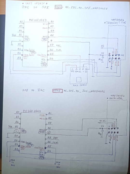

Just had a quick look at W_SPI_to_I2C chart.
This has the nRF24L01,a SPI Master, and two I2C devices. However it appears you are trying to share pins that use differing protocols.
nRF uses a software SPI on pins :-
MOSI = B2
MISO = B1
CLK = B4
CS/SS = A5
CE = A3
SPI Master is using software SPI on :-
MOSI = A6
MISO = B1
CLK = B4
CS/CE = A5
Not sure why this component is necessary nor why they run at differing clock speeds and MOSI, sharing the same CS/CE. Maybe I'm missing something? You also have the MOSI and I2C SDA sharing pin B2. I think you might be over complicating things.
I think it may be better to get this project running in stages, with the first being getting the two microcontrollers talking over the RF link, then adding in the sensors. Hopefully in the next few days I can dig out my modules and get them talking.

I was checked connections between 4 pairs according some examples from wiki for NRF24L01...
I send you schematics as from them I was made hardware for transmitters and receiver...transmitters for FSR and MAX30100 sensors are mobile , receiver was made in one small PCB that include PIC18F46K22 to get received data from sensors, and then send to ESP8266 as the previous project with wired sensors ..So, in transmitter PCB of previous project , I was added 2 pairs of NRF24L01 with PIC, to make sensors wireless..
I would like if it possible to check codes for errors...In simulation seems to works well , but In tests on hardware I can get data on receiver PCB.
Basil
