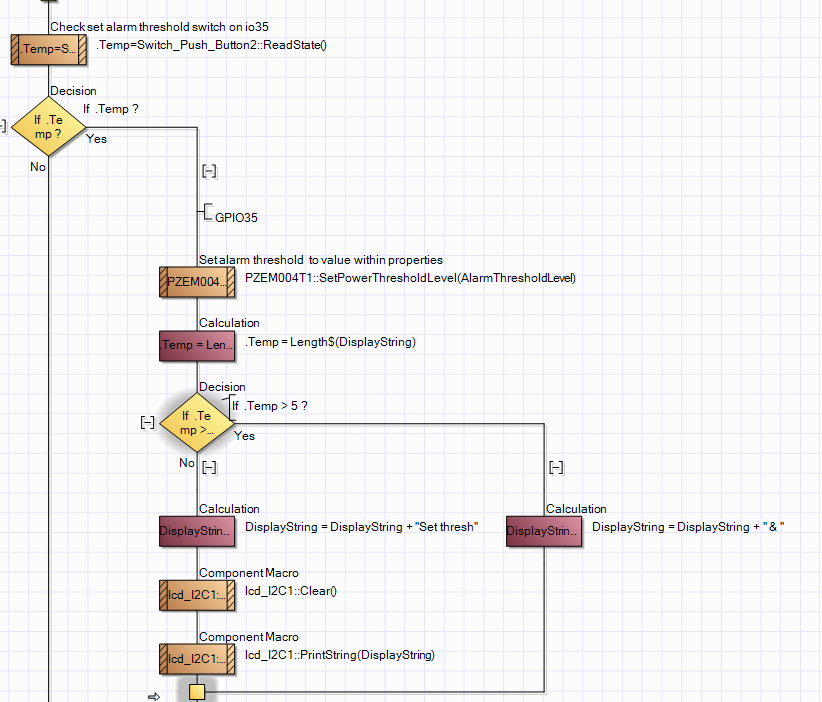

The reason the threshold always read 0 is that you have the wrong function within the 7 branch of the Switch component.
You have a PZEM-004T::Initialise instead of PZEM-004T::ReadPowerAlarmThresholdValue.

Well ok Martin, now it make sense, I will play with it. As mentioned Very usefull device. And fyrthermore, yes I accidentally change the macro "read poweralarm Treshold" to initialise the PZM004 sorry :o it work now

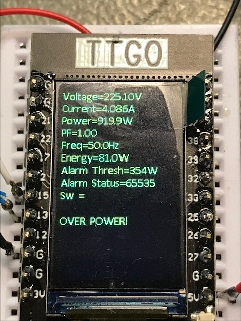

As promised hereby the result of test. The PZEM004 also work with the ESP TTGO very nice ;)
And the overload also work fine, this time I have a heater conneted. :D
Br Jorgen

Posts: 2325
Has thanked: 724 times
Been thanked: 783 times
Re: New component: PZEM-004T Power Monitor
Hi Jorgen.
I'm pleased it's working for you.
The only issue is you must run the module from the 3V supply, or you will damage the ESP32 device.
The notes within the wiki covers that (The sentence just above the red warning).
