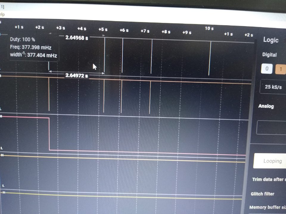

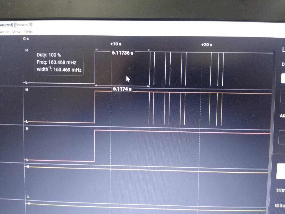

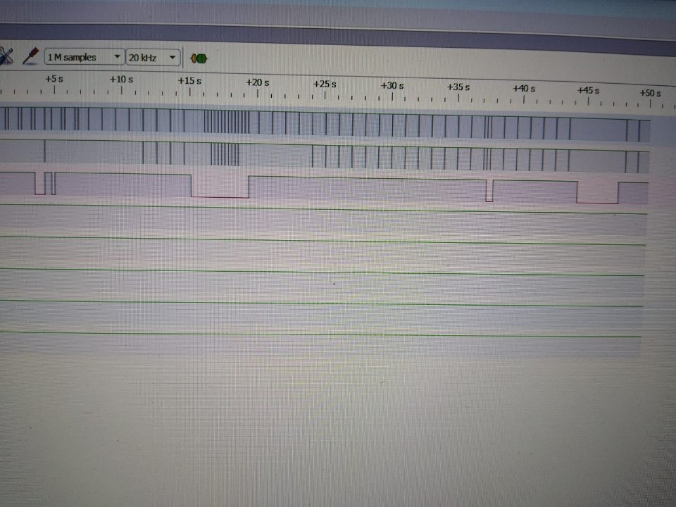

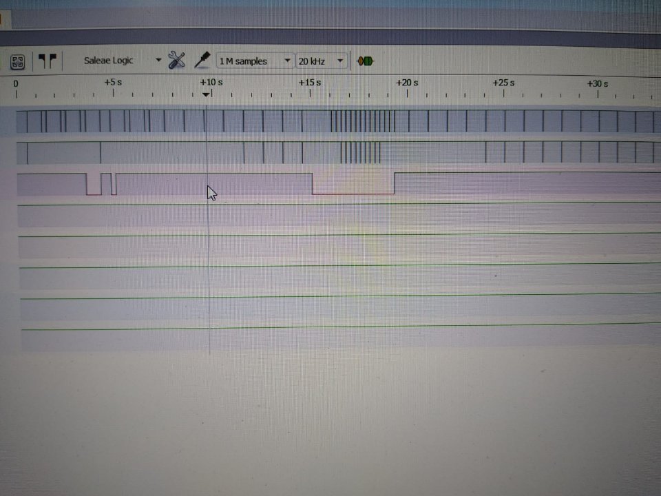

I struggled a little to obtain the signal in logic, but I obtained these signals in pulseview, I hope that these graphs help somewhat for now, I am understanding something about the analyzer, tomorrow I hope to be able to obtain the signal with the respective times using Logic saleae; I see that it has Extensions that can be incorporated into the program; Would it help to incorporate an Extension
Enrique
Enrique
- POT2.jpg (90.94 KiB) Viewed 9152 times
- POT1.jpg (111.33 KiB) Viewed 9152 times

Re: X9C103
there was a change in the function of the potentiometer; When I pressed the Up button (D0), the potentiometer value went to the maximum (9.75 kohm), but I could not lower the potentiometer value (0 kohm) with (D1), it remained stuck at 9.75 kohm.

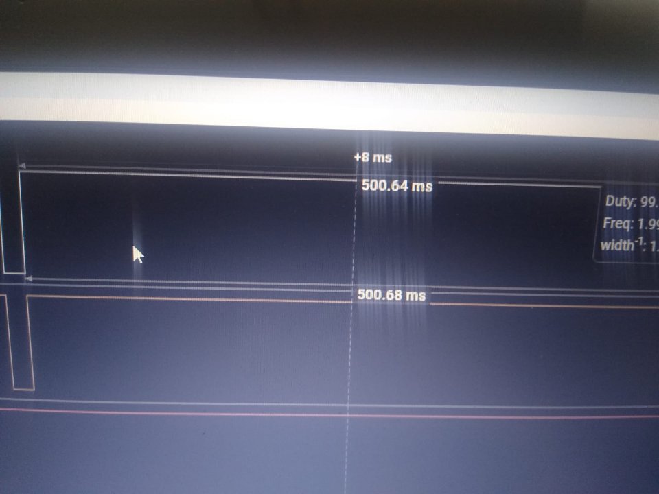

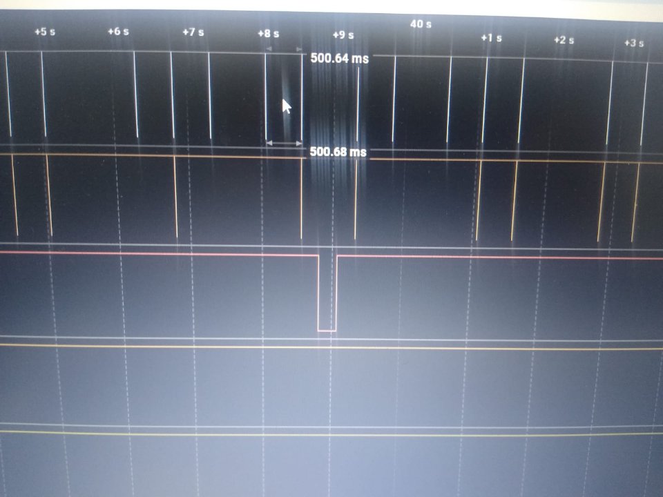

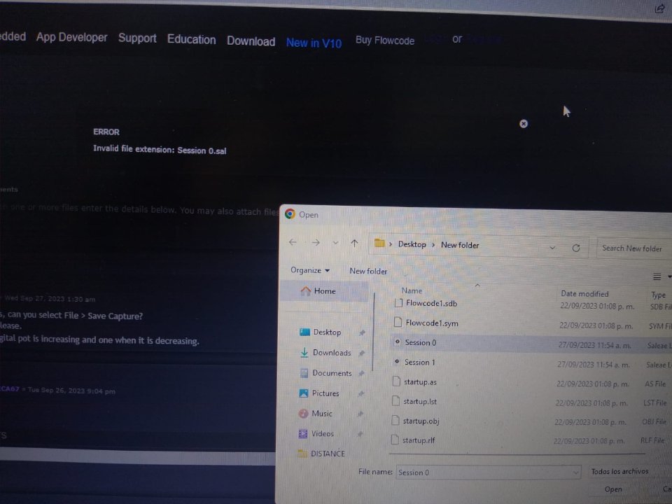

Re: X9C103
Hi Martin,

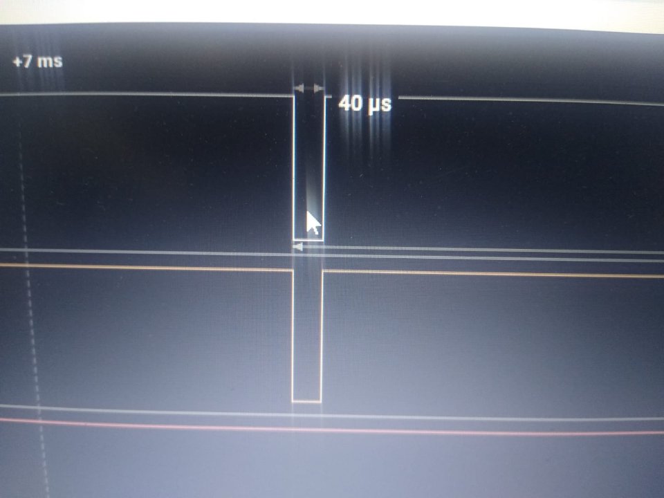

I wanted to send you the 2 files copied from Saleae but the flowcode forum messages did not allow me to send them; I send you the 2 images INCREMENT (D0 PIC) and DECREMENT (D1 PIC):
Channel 0 CS (B0)
Channel 1 INC (B1)
Channel 2 U/D (B2)
I hope I am sending you the correct information you need; The shortest signals have a time of 40 uS.
In any case, if you require other information, do not hesitate to ask me.
Enrique
Channel 0 CS (B0)
Channel 1 INC (B1)
Channel 2 U/D (B2)
Enrique
- Not can send
- NOT_SEND.jpg (70.84 KiB) Viewed 9123 times

Re: X9C103
Hi Martin
Thanks for that. Another member in the "old" forum is having a similar issue. I'll relay the info.
Back to this subject, my understanding, and I might be wrong, is that CS has to go low for the duration of the instruction. From pictures above that does not seem to be the case.

Re: X9C103
Can you try again after
1. Renaming each channel with the function by just clicking on the Channel 0 text etc.
2. Change the speed to 24 MS/s or as high as it will work.
