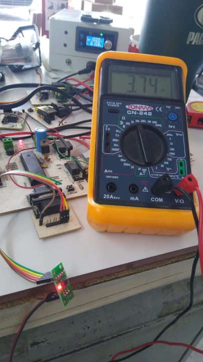

Hi Martin,
I restarted the test of the X9C103 Potentiometer, but I cannot increase or decrease the value of the resistance, the value remains fixed at 3.7 kohm, could you help me? I attach the flow chart.
Enrique
Enrique
