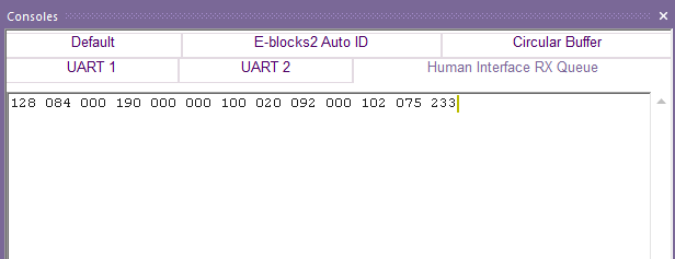

Use Human Interface injector API (see attached modified file) and add the data (e.g. Copy and paste) you expect to the Human Interface RX Queue within the console (Only availablee for professional and academic licences).

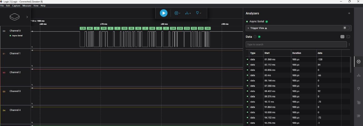

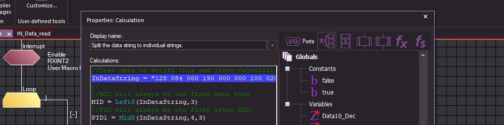

Hi! This is what I have at the PA3 UART2 input. And if I decomment the line as in the screenshot, the trigger fires on screen 221

Yes, your example works as expected without any problems.

Tested UART RX INT2, it responds normally to data on PA3. When the bus is on, 221 is displayed, and when there is no bus, 241 is displayed, that is, everything is ok with the hardware
