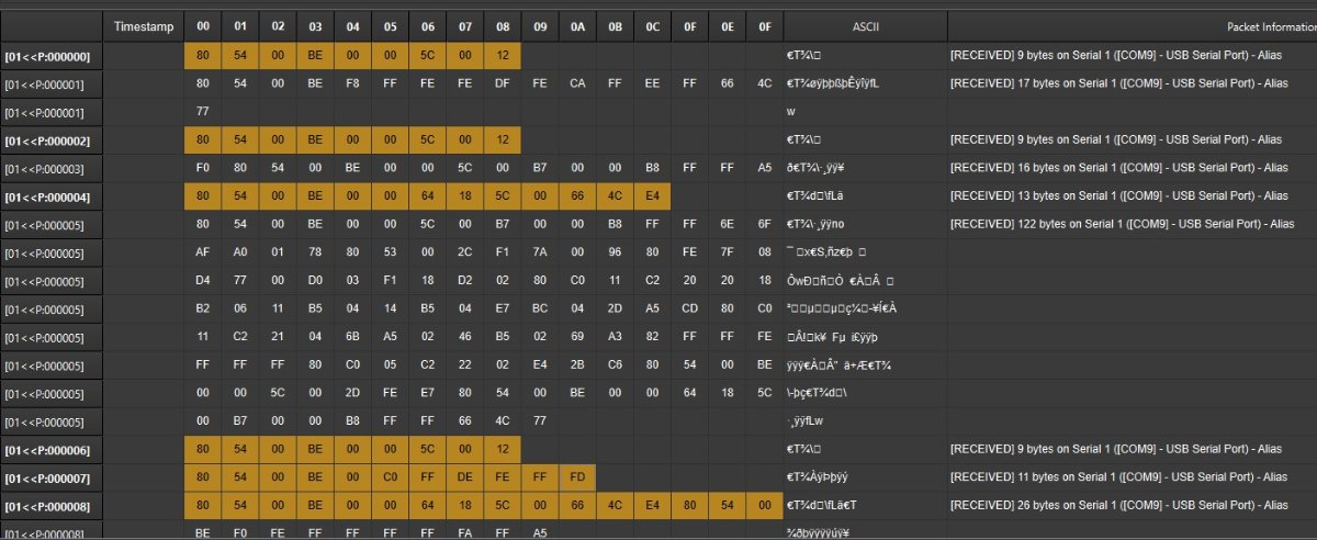

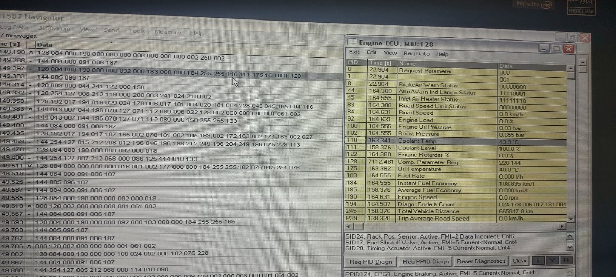

Re: Protocol j1587
Hi!
Here is a fragment of data taken from uart via USB/RS485, you can see there that the packet starts at 0x80 if in hex and in the next screen from special software, j1587 Navigator, from Volvo, and there you can also see that the beginning of the packet starts at 128 in hex 80 But when all the blocks and other packages appear on the network, for example MID 144, MID 130 and so on, now I only have MID128 on my desk.
I can't connect external COM to FC, I think it would be easier that way

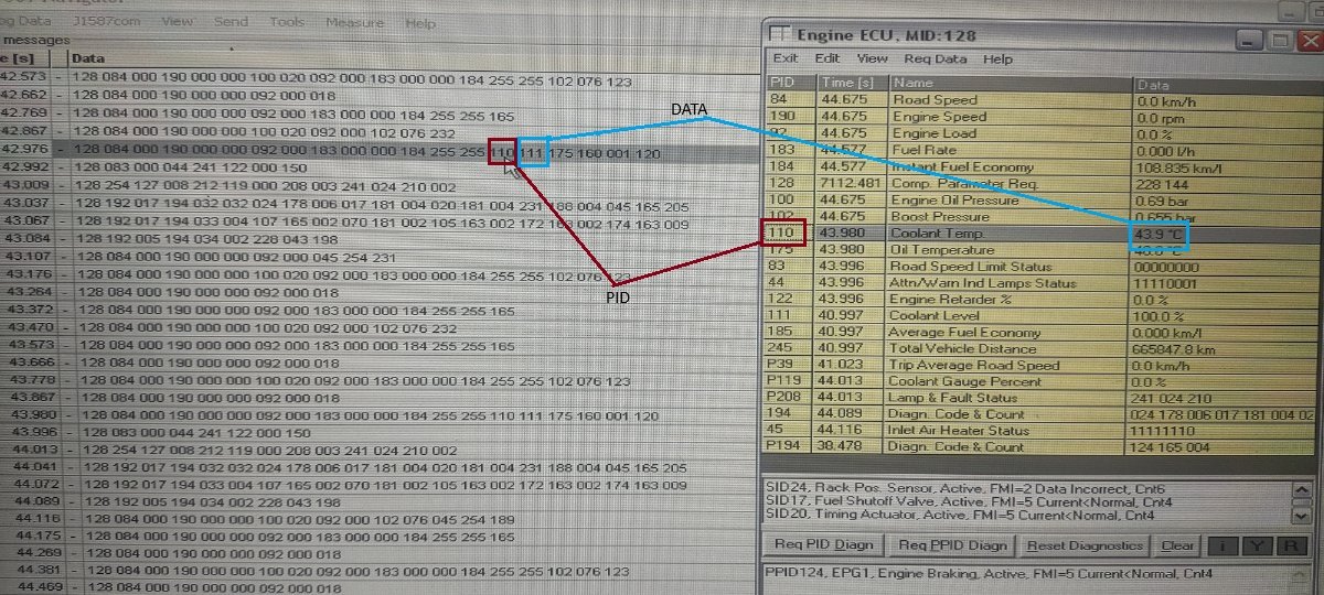

Re: Protocol j1587
A couple of questions.
Out of curiosity, what PC program is it you are using to capture the hex? Is it connected directly to the UART/485 and is the only software running or is it "monitoring" some other software action, perhaps even a bus between modules? I ask as most scan tools I have came across, and that isn't many, interact. By that I mean the user issues commands and the target responds.
As Bob mentions above, there are many protocols and J1587 is quite old with a lot of documentation out there. I found this which may help explain the protocol and physical attributes. It is by Pico, a manufacturer of PC based "scopes" frequently found in garages etc.
https://www.picoauto.com/support/viewtopic.php?t=22640
Depending on your PID, the returned data length varies but in a defined format. The protocol also defines how the data is interpreted so that in your example, PID of 110 with (a single byte) data of 111 translates to a temperature of 43.9. How do you plan to do this conversion or doesn't it matter?

Re: Protocol j1587
Hi!
Program ,, Serial tool 1.5.0,, .
The engine control unit itself always transmits this data to the network, immediately after power is applied, without any requests. And I just connected the bus via USB/RS485 to the PC and monitor. But I know that you can send commands to it and it will respond to requests, just like Volvo software does. In general, this is a Volvo engine, and I want to install it on my tractor, and I need to see its parameters during operation. I'm not a programming professional, but I'm good with electronics.
