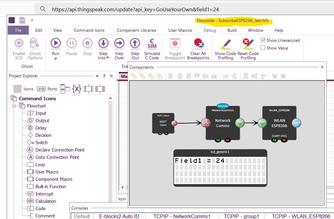

ThingSpeak is in my opinion very, very user friendly.
Have you created an account? If so have you used a browser to update fields and to read fields? Have you read their documentation on how to connect/publish/subscribe using API Keys and MQTT? If you haven't done that to understand how it works, you can't really expect much success.
There isn't anything difficult and the WiKi example(s) work fine if you use them correctly. Indeed I just modified the "Subscribe using ESP8266 example" to subscribe and fetch TS data. It sits there apparently doing nothing until data gets posted then if by magic the value appears on the display. That took about ten minutes to modify and get a reading returned, mainly as I did not have my credentials to hand and I wanted a specific pair returned. Using my browser I can update my TS channels and as FC allows me to simulate, the chart then prints the value of interest.
Screenshot 2025-01-21 000310.jpg (138.08 KiB) Viewed 9180 times
I haven't included a chart as it is essentially the same as the WiKi, except with my specific credentials and a modified "print" statement.

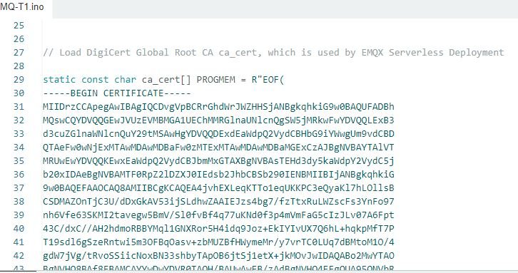

I was able to connect to public (free) hivemq and emqx mqtt brokers with flowcode and I can send data (For example broker.emqx.io port:1883). But I can't connect as private mqtt, password etc. everything is correct (For example my broker address is y131ffc0.ala.eu-central-1.emqxsl.com port:8883)
I researched a lot why this is happening and examined their own sample codes. At first I couldn't connect with their own samples either. But then I found the solution. There is a certificate code in the code (in the name of the ca certificate). When I changed that code to my own ca certificate code, the connection was established.
Now I think the problem is caused by this certificate code.
How can I add this ca certificate code in FLOWCODE?
Posts: 2061
Has thanked: 311 times
Been thanked: 479 times
Re: thingsboard, hivemq etc. using ESP32 or ESP8266 MQTT. I failed to send data. What am I doing wrong?
Thanks for the question.
Flowcode does not currently support client-side certification for MQTT applications, but we are looking into this.
There may be settings in the MQTT server (broker) that you use that allow 1-way TLS certification (i.e. server-side certification) which may provide a partial solution.
