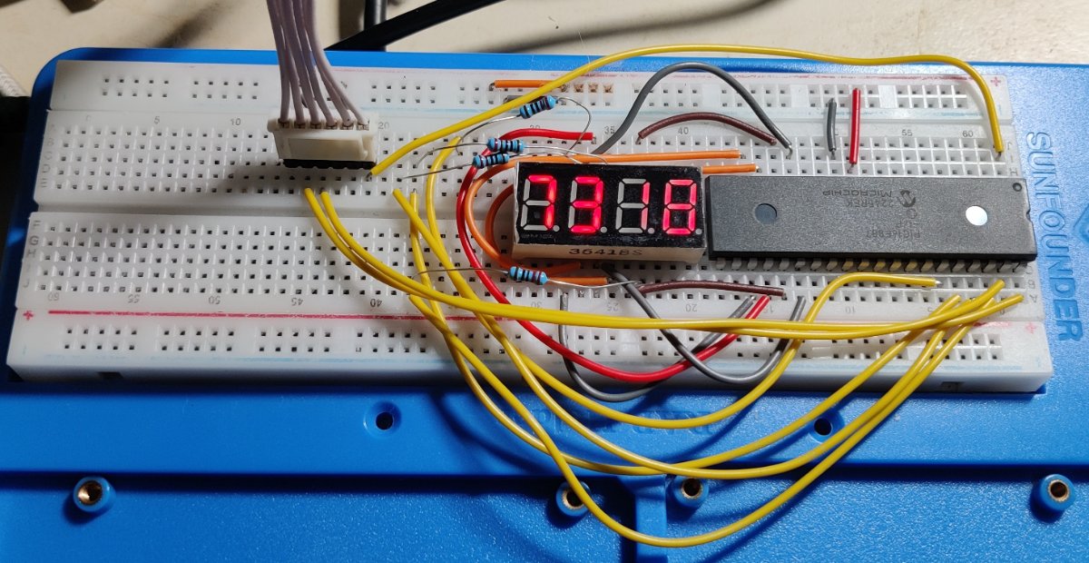

Well - inspired by chipfryer27 I had a beer... Ooops - no I wired up a 4 digit 3641BS display. to a PIC16F887. This has an 8MHz clock (internal - ext can go up to 20MHz) - took a bit of fiddling to get an interrupt rate that looked acceptable with no flickering.
Things did not go smoothly. The device has 4 digits ( - the wiring is the same as for 3 displays it's just internal :-) )
I made a mistake and wired b2 to display 1 .. b5 to display 4. I've confused myself with the digit select - can't work out how 0b1000 >> digit to the select pins (d2..d5) works unless output reverse the byte...
The display then seems to have opposite logic to yours - so common had to be high and .... So - although it would have made more sense to use the 4 digit display component (probably - I didn't test it) I scrapped the displays in the end and made multiplex work without...
I used 220Ohm resistors on the display select lines - I notice that display brightness varies slightly depending on how many segments are set - I don't have the patience to have a resistor on each segment pin - which is what it needs, but too fiddly on a breadboard!
My use of segments - from the look up table - needed to invert the value (using the ~ operator.
As there are four digits to play with - I set the initial temperature to 1234 (123.4) and set 'overflow' as 10000. I don't have a thermistor attached so just increment the value in a loop... Power is from the PicKit3. Despite the photo - '1' would be a brighter digit (less segments to light)
It's not quite right - the decimal point on digit 1 ((at right) flashes... In fact '0' has the wrong data - showing as all segments set (hence the dp flash...) Fixed - typo in lookup data....
Multiplex HW.fcfx
(29.69 KiB) Downloaded 183 times
