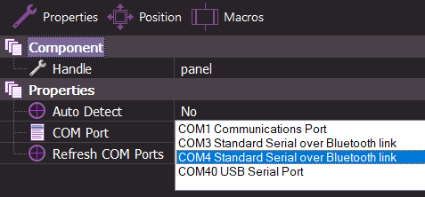

For now I removed all recorders, except one recorder.
For one Bt modull the computer shows always 2 comport.
So the program from Ben found the recorder, choosed the correct comport (com4) and not the wrong comport (com3) from the BT device.
and started recording and stoped the recording after 10 seconds.
So with one recorder perfect!
In the dropdown menue is this.. If it's posible to show more info in the dropdown panel, like the VID PID will also help to choose from hand.

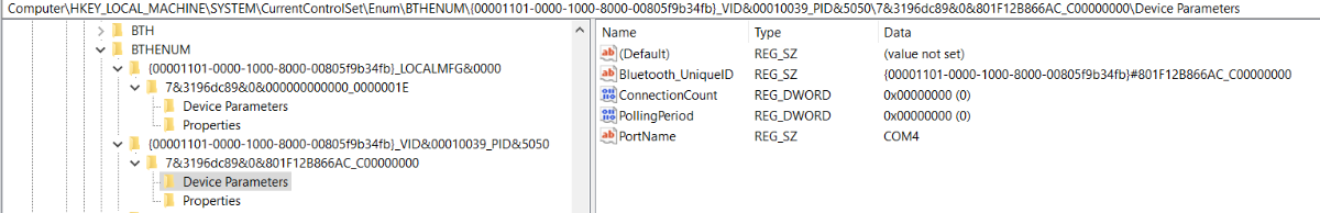

We could add the VID/PID to the list, but I think for your BT module this will show the same VID/PID for the 2 COM ports associated with it. And if you had multiple modules of the same product connected, these would also show the same VID/PID.
I've looked into this and I think Windows stores COM port info in a complex way. It depends on the type of COM port. For example, my PC identifies 2 COM port entries in the registry (Computer\HKEY_LOCAL_MACHINE\SYSTEM\CurrentControlSet\Control\COM Name Arbiter\Devices) - one under "ACPI" and one under "USB". More details of these can be found by finding each entry in "Computer\HKEY_LOCAL_MACHINE\SYSTEM\CurrentControlSet\Enum".
If you have a look at these areas of your registry and find a way of differentiating them for your needs, then I might be able to find a way of exposing this information in Flowcode.

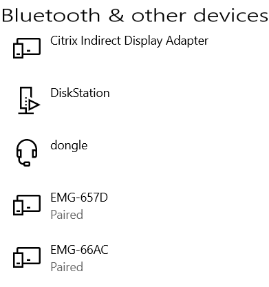

From all my Modul i now the Bluetooth_uniqueID .
From this modul is 801F12B866AC. From this I generate the BT name EMG-66AC (the BT modul has a command to creat the name with a string and the last 4 numbers of the ID)
How can I read the Bluetooth_uniqueID in the computer?
I tried with getprop, but it's not working.I did something wrong
