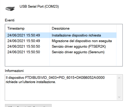

Re: Automatic Com port Select
I am trying to use the program but it does not detect the com port. This is what I see from device manager
Kind Regards
Kind Regards

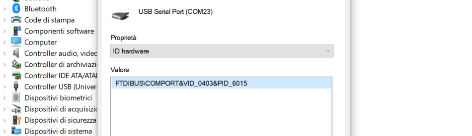

Hello Steve
i tried different combinations but can't find the com port. The id name from windows is VID_0403 & PID_6015.
the device in question is a very popular ft234xd
Kind Regards
Kind Regards

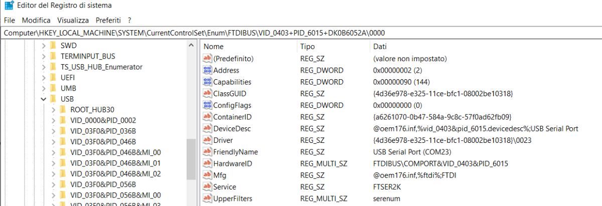

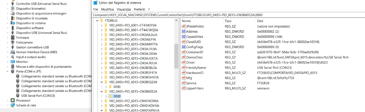

You could perhaps search through your registry for "VID_0403" and see what it there. It should be somewhere within "HKEY_LOCAL_MACHINE\SYSTEM\CurrentControlSet\Enum"
The "ScanForDeviceID" function in Flowcode calls the Windows API which effectively looks at this registry location for the VID/PID string in the "HardwareID" entries. It then returns the equivalent "FriendlyName" from the same location.
For example, when I tried to detect the Uno, the information was found here:
In there are the following entries, which are used to detect the port:
Computer\HKEY_LOCAL_MACHINE\SYSTEM\CurrentControlSet\Enum\USB\VID_2A03&PID_0043\85439303033351216280-
- Posts: 1961
- Has thanked: 292 times
- Been thanked: 458 times
I think that explains it. Our code specifically looks within the "USB" enumeration. Unfortunately, it looks like the FTDI device works differently to other virtual COM ports.
