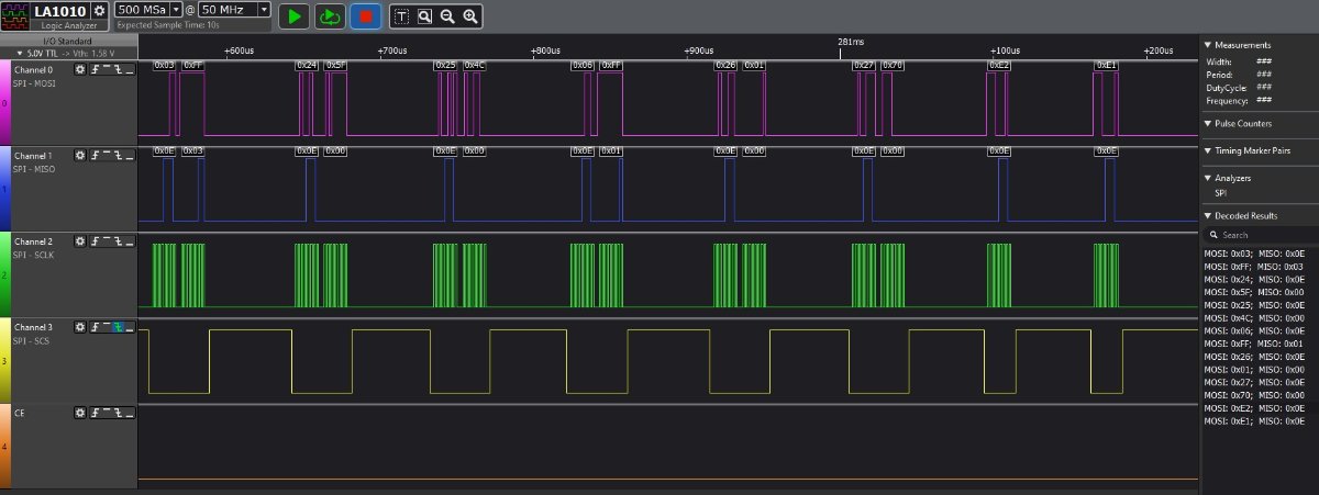

Got my connections sorted and I can now get a reply from the module. From the documentation I noticed that Data is valid on clock leading edge but my analyser had it on trailing. Obviously this makes a big difference to what is being decoded and once I set this to leading and clock low when inactive I could then get MOSI that I could "understand", by that I mean I could understand what registers were being W/R (or attempted).
I'd halted the flow at strategic points to allow me to focus in on certain commands (monitored on pins). This is initialise.
When the program loops and "counts" I don't get any confirmation on the UART:-
START
1
0 - 0
1 - 0
2 - 0
etc
No time left for today, but at least we know that the example code does communicate with the module :)
