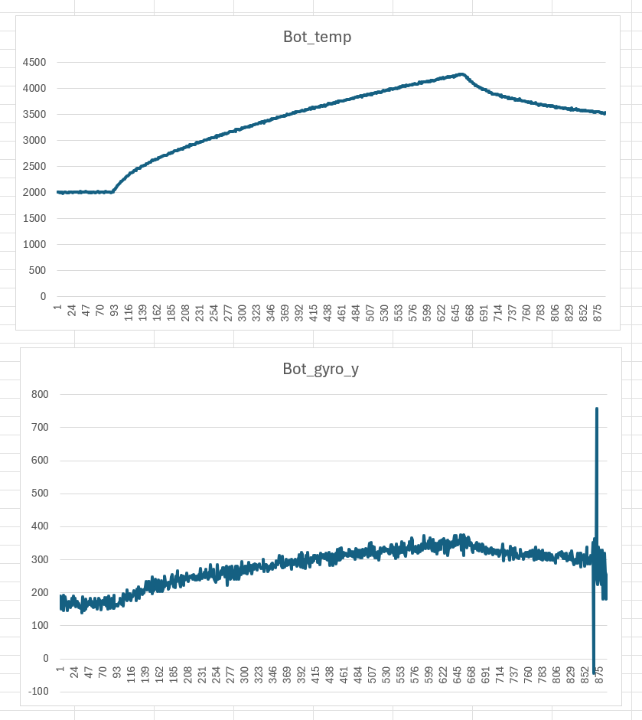

Unfortunately I can now see that the offset of the gyroscope changes with the temperature :)
change with the temperature;

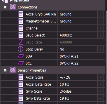

At the moment the I2C clock is still causing me problems.
With the LSM9DS1 I have to change the configuration every time I load the program, otherwise the LSM9DS1 remains in software mode.
This means an I2C clock of 25Khz measured with the oscilloscope. It would be an advantage if the component works properly.
If I then select Channel1 and 100khz for LSM9DS1, the clock runs at 100kHz.
But if I set LSM9DS1 Channel1 to 400Khz, the clock still runs at 100kHz

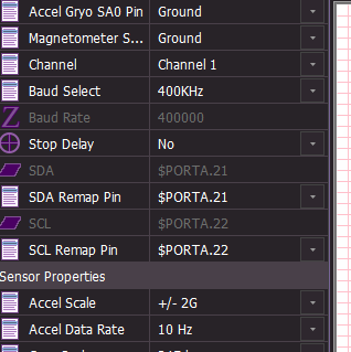

I have done the update, unfortunately it changes the components back to software mode when loading again. :)
before:
after save and load.
A demo program:

Now everything works perfect! Saving and reopening is now ok.
All bytes and values are also ok.
Also the speed of the I2C bus is now 400kHz as it should be.
(The cause was MCP960X_Thermocouple1 for the slow speed. I have set this MCP960X_Thermocouple to I2C software mode.)
