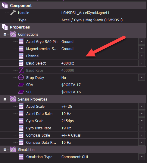

With the LSM9DS1 component i can not compile,
and there is a problem if i load the program again, the I2C channel is not longer select
Maybe some problem with the channel?

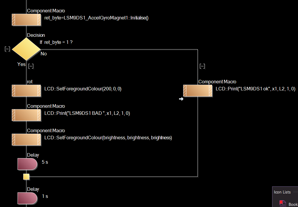

MX_UINT8 FCD_0ea61_LSM9DS1_AccelGyroMagnet1__Initialise()

Re: ESP32 and LSM9DS1 not compiling
Hi Stefan.
For the channel issue can you try the attached, please.
- LSM9DS1_AccelGyroMagnet.fcpx
- (8.4 KiB) Downloaded 651 times
- Posts: 2453
- Has thanked: 792 times
- Been thanked: 850 times
Does not look like the channel issue has worked, so back to the original statement
It was worth a try.The channel issue requires more looking into
Hi Martin
Thanks Martin. I can compile now.
The channel select is simply for me to work with it for a while.
Just select channel1 when loading the program.
I will test the component to see if the measured values are correct and let you know how it goes.

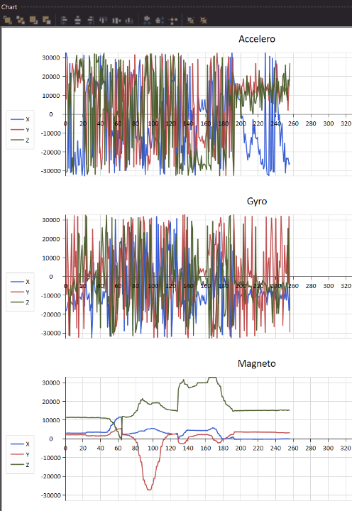

Hi Martin
The LSM9DS1 is working.
From the magnetometer the data looks good.
But the data from Acceloro and Gyro dont look correct.
as if the result is not on the correct place in the 16Bit signet integer and then the +- bit is wrong....
I have also noticed this with the component BMM150. There I read the register and set the two 8bit together to a 16 bit signet integer, then the data was correct.

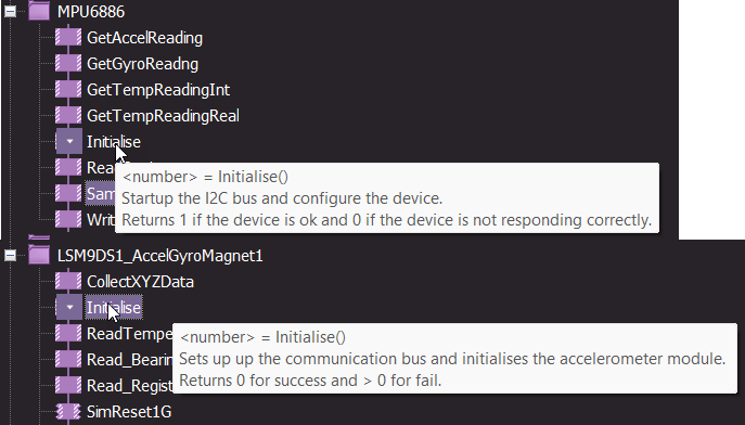

only a small hint...you have to pay attention to ... to change (swap) the IF for using it instead of MPU6886
- Snag_7a2a5a.png (61.86 KiB) Viewed 9881 times
Hi Martin
Do you already have an idea for a solution for setting the channel every time?The channel issue requires more looking into
