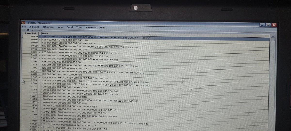

Here is an example of a message stream with the timing of each message

Okay, never having played with the Nextion it seemed something to rule out, which you have, so that's good.
Looking at your chart, in addition to Martin's comments about getting rid of certain components, I am a bit confused (easily done).
What it seems you want to do is:-
You interrupt to capture a string of twenty characters, then convert the first character to a numerical value and if the value of the first character is 128 you then fill the array with the remaining characters before exiting.
Then if the value of the 14th character is 110 you branch to further process the 15th character and display.
If 14th isn't 110 you then test character 6 in the same way, then character 16.
So basically you check if character zero is 128 then if character 14 equals 110 you process, if character 6 is 100 you process and if character 16 is 102 you process.
Using your screen grab as an example, the first time characters 0 and 14 match requirements is at time 0.913
When 0 and 6 match it is at time 0.108
When 0 and 16 match it is again at 0.108.
The next time characters match for 0 and 14 isn't shown
The next time 0 and 6 match it is 0.402
The next time 0 and 16 match it is 0.711 however at this time 0 and 6 also match.
In your chart you branch if certain characters match and if so process for that specific match and if found ignore the rest of the capture.
So once you initially branch for 0 and 14 if found it will not process anything else in the string. However as both "0 and 6" and "0 and 16" both appear in the same string, after you find 0 and 6 and process you effectively ignore 0 and 16.
Now the confusing part.
It looks like you are capturing string values separated by some value (possibly a space) as your screen grab shows for first line
"128 129 017 194 033 004 107 166 002 070 181 002 105 163 002 172 163 002 174 163 008"
You then convert the first character to a byte value. As the above is a string the first character is 1, the second 2, the third 8,the fourth space(?) etc so I don't understand how you are branching. I may have misunderstood something.

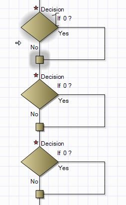

Just remembered you are actually receiving dump of Hex (I think), so in your main loop, test for each "match" sequentially instead of going to the end of the loop after a match is found.
So have a decision for Char 14 and in the"yes" branch, process.
Then after the above, have another decision branch for 6 and process.
Then after the above have another decision branch for 16 etc.
That should give you the values.
I can understand it being slow but once you can capture all your required data we can look at how to improve.

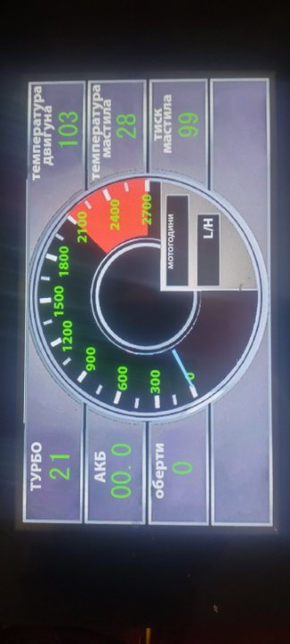

This is what happened - all the parameters are on the screen.
I just can’t understand the engine speed (PID190), there are 2 bytes of data, how can I convert them to Uint? It works very slowly.
I believe that it is difficult for the controller to catch the beginning of the line (128)...
