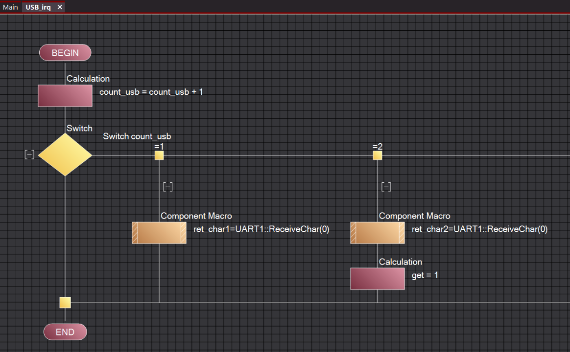

Hoi Chris, Hi Martin
I have similar problems with the uart with the STM32.
If I receive two characters (bytes) for example “AB” then the result was “BB”.
But with the PIC32 and ESP32 it was easy to send and receive data arrays.
Also in connection with the PC app. This was also never problem via Bluetooth.
One more question Chris, do you have a little more info about your setup with the ATMEGA328 , Ibus and camera?
Maybe I can use that too.
I only need two characters for my connection. Here is my example.
Need a counter to get both:
FC10_STM32_F469_1_post.fcfx
(23.75 KiB) Downloaded 198 times
