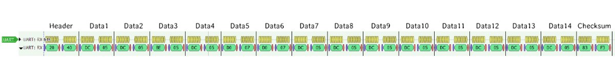

Hello Martin,
many thanks for your demo chart. It works great so far, only the results of the data do not fit. The values should be between 1000 and 2000. Do I have a problem with the UART transmission?
Attached is an example chart of what I would like to receive.
Best regards Chris
Best regards Chris

Re: UART Transmission with atmega328p
How do you mean 'values do not fit'?
I had a brief attempt to convert to 16 bit values (which should allow the data range):
.dataRcvd[.i] = payload[.i *2 +1]
.dataRcvd[.i] = (.dataRcvd[.i] << 8) + payload[.i *2]
Did I mess this up (did i make dataRcvd byte for example)?
